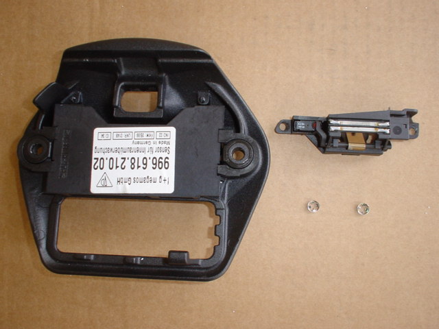

You need to replace the switch on the right in the picture, which was redesigned after your car was made.

Thanks but .... Where is the switch located on the car?
Do you have a part #??

The switch is located in the windsheild frame, where the hook for the cabtop is manually latched.
