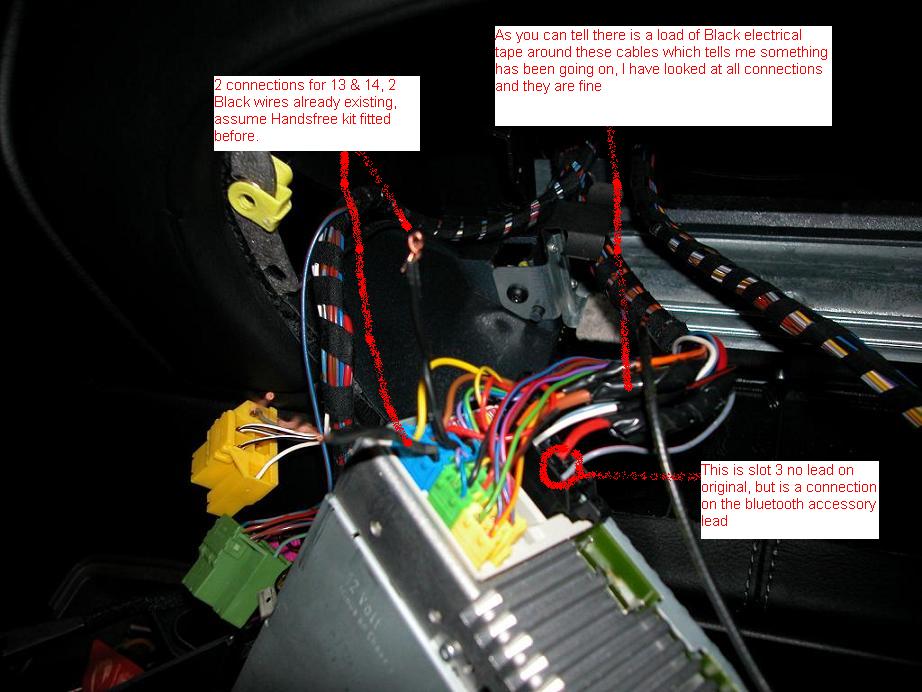

I think I have located the problem it's on Pin 3 (diagram attached) for recognising the Handsfree system, The original adaptor doesn't have the cable in the slot!
What colour is this cable, so I can try and locate it or does anyone know where it could be (It looks like a previous owner has had something in there as there is a few cables been taped up)
It should come from a 4 pin connector behind the center console for telephone prep. No idea why it is disconnected unless there was a different radio in the car at some time.

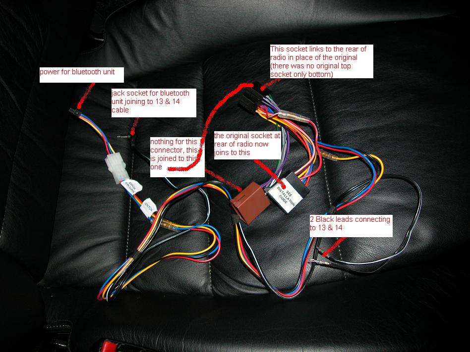

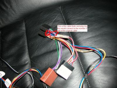

Hi X, I did programme the radio but still no joy! I was wondering what was going on as the system works (power, can talk, etc) but it doesn't come through speakers or mutes the radio, so I started tracing it back and noticed that the number 3 slot cable (diagram) was missing, this is for recognising the phone system is active!
Don't know where else this cable can be!

The signal comes in through the phone prep connector and goes to the radio (Yellow/Black) wire. If you look at both the radio wiring diagram and the telephone wiring diagram you will see both ends of the Yellow/Black wire.
Here is Gary's iPod install you can see where the connector is in the front console.
If you need more pics from his iPod install look here.
As Loren mentioned, the Yellow/Blk Stripe is for radio mute on the 4 wire connector behind the center console. When I installed my Bluetooth, I didn't use the (3) pin off of the conn. 3, only use the pin (13) and (14) for audio input. Have you check those 2 pins to make sure they're properly inserted in the connector (1). I believe pin (13) is (+) and (14) is (-).

So why does it not mute the radio and ring through the speakers when calling the phone, 13 & 14 are in correct position, i'm gonna take some pics, because this is completly frustrating!!!
Have you tried to ground out the pin#3 (mute) on the radio to see if the radio display "PHONE" on it. If it does then the carkit mute trigger output is too low to trigger the radio. On some car kits like SonyEricsson, you have to add a relay to make it work. Also, have you tried the Yellow/Blk wire for mute instead of pin #3?
Where is this connector (yellow/black wire) located? Because I can't see it anywhere!
Are you saying I should patch this into the empty line 3?

Look at Loren's Pix above, it is located behind the CD/Cassette holder. Just pop out the side panel and you'll see it. There you'll find 12+, ground, Ignition Sense and Radio Mute all in one connector.

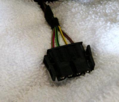

Looking at your connectors ,it appears to me you're using the PARROT CK-300? bluetooth kit right? If so, did you ordered the kit with specific Porsche cable?
It's the Nokia kit CK-7W, cable was ordered seperately but is the correct item!
