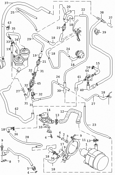

The sound of the pump sounds like a small vacuum cleaner to me. Usually it runs for a couple of minutes at start up.
The pump is located in the left rear most area of the engine compartment. Item 1 below (air injection system).
Checked the 40A fuse and it's intact. The hoses seem to be connected, but I do not think I could find them all. The electrical connectors are OK (BTW, I found the airpump on the right side of the engine compartment).
I can hear the airpump on cold startup, but it has a moaning/groaning sound. I guess that could be a bad pump, faulty valve or a leak. Looks like I'd better take it in to the dealer for a PST2 scan.
