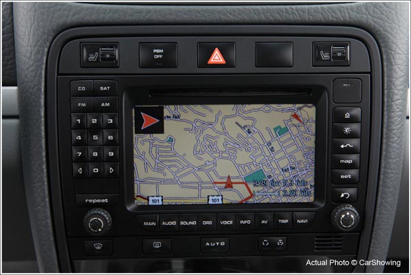

Thanks for the reply but looks like that is for PCM 3.0 and I have PCM2.1 on 2005 Cayenne. Is there a way to install this module, is it plug and play?

post-51977-0-17235000-1306182773_thumb.j
