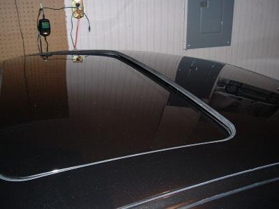

For some strange reason my sunroof on my 996TT won't automatically close to the correct position.
It constantly settles at a down angle (as seen in the pic) instead of being flush with the roof like it should be. All fuses are good...and I can make it flush with the roof by manipulating the sunroof button...but it won't do it on its own anymore.
Anyone have any idea what could be causing this? TIA.
Loren...you are THE MAN! Not just "A man"...but "THE man". Thank you for that...it worked immediately. :cheers: :thumbup:
Now I just wish Porsche had decided to out it somewhere in my Owner's Manual. I literally went from back to front again in my manual and could not find anything like that anywhere. :angry:
