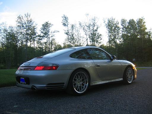

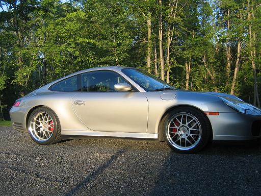

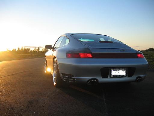

I'll give feedback when i've driven the car some more. The c4s came with the US sport M030. I have kept the original springs (only 12 000 Km on them) just in case i'm not happy. The car rides softer with the H&R's on it for sure which is nicer for the street but it does feel a little less "on rails" in corners. I don't really push the car to the limit though.
here's the car with the H&R's on the original M030 shocks
rides great
Car looks great I have an 02 C4S and am planning the same mod as you did maybe this winter.
The H&R description says 1" drop. I imagine that this is from stock US height.
When you said M030 shocks , did you mean the original C4S shocks and if so how much drop did you realize? I thought that the C4S was supposed to be 10 mm lower than stock anyway?
Any chance you could measure your tire OD and height from ground to top of fender lip front and back so I could compare to try to determine where I will end up?
rides great
i'll do the measurements this weekend after i wash and wax the car and i'll post some better pics.
i am pleased with the ride so far. no bottoming out, the cornering seems better than when i first drove it after the lowering. i've received more compliments on the look/stance of the car since lowering.
