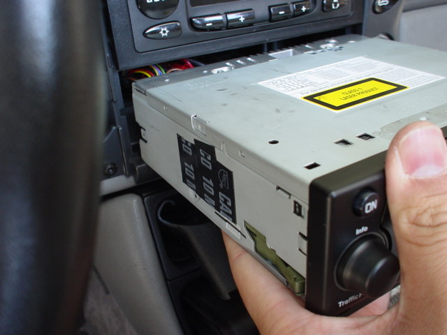

So i replaced my HU with a Clarion Mp3 player. I didn't use a hardness adapter but i spliced into the factory harness. Anywho, now my alarm honks upon arming/locking the car. So is there some wire that needs to be connected or grounded? Also what's that one wierd wire that connects to the dash piece. It looks like a ground wire, but don't know

The radio alarm contact is touching the side of your new radio and creating a ground, so the alarm chirps. If you look at your original radio it has a plastic insulator on the side, which your new radio does not have.
So you do what Loren says or put a piece of tape on the side of your new radio, like in the picture.
thanks guys, i just removed it and taped it off. works great now. only sad part i spent about 20 minutes trying to find out why the rear speakers that I don't havve didn't work.
