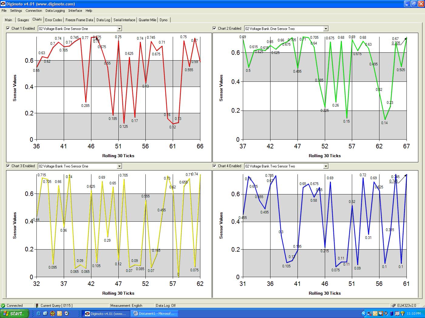

Here is a chart of my runtime O2 sensor readings at idle. Let me know what you think.
Kyrak.
Well the O2 sensor readings should be oscillating back and forth between .1 ane .8 volts. The bank 1 readings looks pretty strange. The bank 2 readings look better but still look a bit odd. I have attached a spreadsheet that shows what my car (1998) looks like.
You could try pulling the sensors and having a look at them for any obvious problems. You could then swap them between banks to see if the readings follow the sensors.
that's kind of wierd. since niether coil is getting voltage on the IAV, check that pin 2 to on the IAV wiring harness is getting ~ 12V at idle. your O2 sensor reading may be a symptom of the idle issues. when you reset the MIL, how long does it take to throw the codes again?

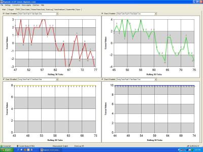

you have your short term fuel trim graphs above. could you post graphs with your bank 1 / bank 2 short term and LONG term trims? that will help.
Here ya go, it seemed like this was a weird spike so I screenshotted this set of readings.
Kyrak
Your maf readings (I assume they are 8% and 10%) are off. They should be around 0%. I do not understand your O2 readings. They should look like a sine wave. Yours do not unless you have some other graphs.
If you had the IACV replaced but it still throws the same codes then I would go back to the people that replaced and ask why you still have the codes.
The 8 and 10 % are the LT fuel trims that insite asked for. My MAF flow rate is at 5-6 which is within range (shown in the 2nd post). I am assuming that the IAVC was replaced correctly, but maybe the simple answer is either a bad replacement part or faulty installation. It was done by a shop I trust though. I asked them to replace it after researching and finding all my symptoms to be consistent with IAVC problems. Any other ideas? I can get some more O2 readings if that would help.
Kyrak
MAF readings at idle do not mean much. You have to check it at higher rpms to see that the MAF functions correctly over its operating range. You can look at one of my prior posts to see that mine was okay at idle but underread at high rpms. Replaced the MAF and problems went away. I am not saying that the MAF is your problem but LT fuel trims should be about 0, if not then something is not right.

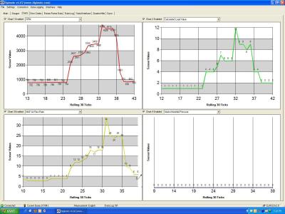

My foot is not as steady as yours, but hopefully this graph will do the trick. My readings certainly aren't anywhere near yours in your old post. Let me know what you think.
Kyrak
i'm pretty sure it's your MAF. your readings are good at idle, but the long term fuel trims indicate that your car is running lean at speed (these should both be roughly zero). do you have any hesitations when driving the car (around 5K RPM or so)?
