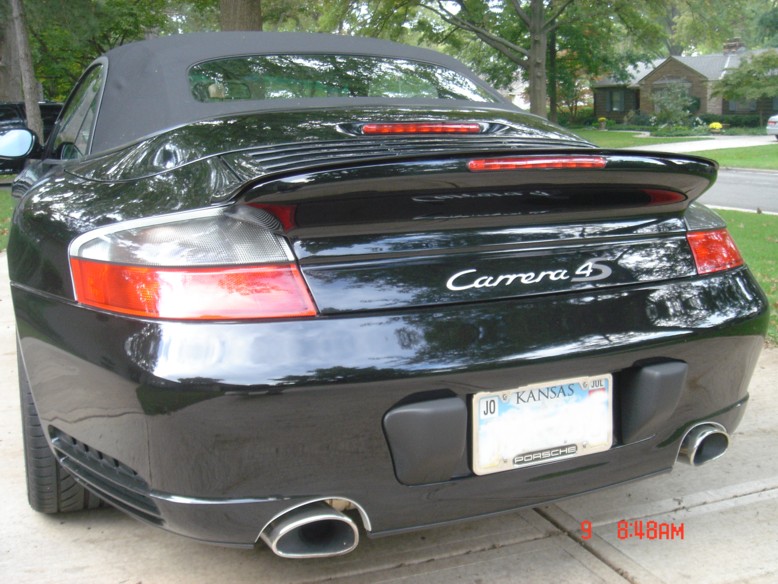

It was a tough job, but I made it work.
For starters, the decklid fits on the car, but it won't close due to the "pistons" that push up the spoiler at 75 mph. See other details here:
Discussion about making airbox work
It required the following modifications:
1) Move the air pump (aka smog pump)
2) Cut out part of and re-seal the airbox
3) Cut a new hole for air intake in the underplate of the turbo decklid
4) Seal the turbo air intake hole in the underplate of the turbo decklid
5) $50 for the new "badge"
Yes, I realize that I now have two center brakelights and it does look a little funny, but only the spoiler one lights up when I push the brake pedal.

congrats! you did it! now, shall i get that wing or the misha gt2 wing... i like the turbo one more but so much work..
Looks great, I'm gonna try it myself this winter. A9, I'd pass on the mishagt2 wing, I had it, just too in your face, you'll be tired of it in a week.
haha, i think i'm going to pass because with it on, my car cover won't fit over it.
do you know what wing is this?
is this the misha wing?
Edited by a9jlu

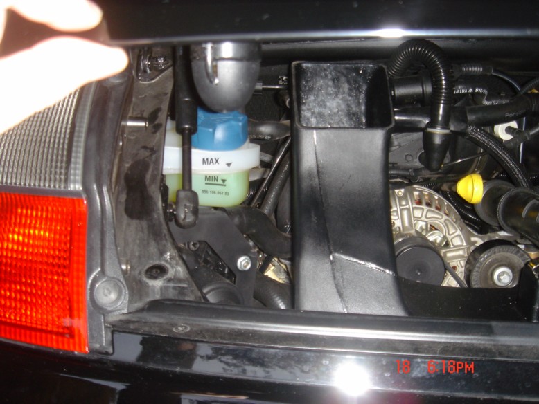

Here is some more information on this:
I moved the smog pump by using the bracket that comes with an EVO air intake kit. I was able to secure one of these from the local shop: "Imagine Auto". It was the last one they had. It looks like this:
(the factory bracket is on the left)
This moved the air/smog pump out of the way like this:

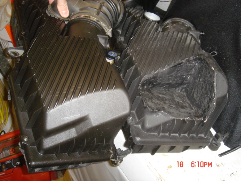

Then I cut a section out of the airbox and used Bondo to seal it up.
(I am not very good with Bondo.)
Then, when I wasn't real happy with my bondo job, I bought an EVO induction kit and put it in there:
(The problem with this is that I don't like the way the EVO sounds, so I'll probably change back to the bad bondo airbox.
