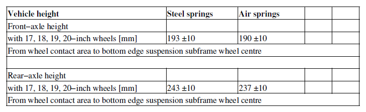

Does anyone have any typical measurement values for the calibration? I have one that someone tried calibrating, so when it tries to go to normal level during calibration it jumps to the top right away....
If the vehicle is a Cayenne with air suspension, it must be adjusted to normal level. Adjust from the low level to the normal level for the vehicle. The vehicle may be aligned and adjusted in this position only.
If the control module or one of the level sensors was replaced, calibration must be carried out with the Porsche System Tester.
Click image to enlarge
ya '07 Cayenne with Air Suspension....
It was put on a lift without disabling air suspension.... the tech apparantly tried to calibrate it afterwards and now when I try to run the piwis cal... it goes to low level first then tries to go to normal level but shoots the rear to the top...
