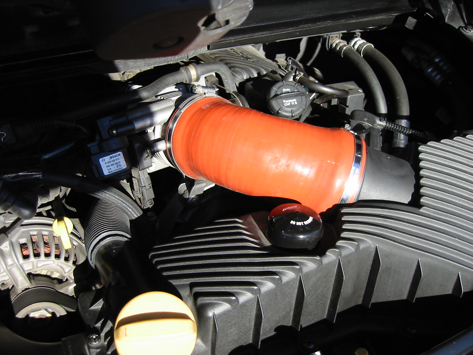

Folks, I received the Vertex - Schnell air intake for my C2 . I installed it in 15 minutes( which also included the time it took to find a screw driver and reading the instructions). I will let you'all know what I think of it in a few days. I have a 200 miles trip tomorrow.

Harry,
I note that there is a small cap on your airbox (which is part of the Schnell kit) does this allow you to remove the 'muffler' within the airbox to free up more space within or do you simply place the lid on the existing opening, still keeping the muffler within the airbox in-situ?
The fabspeed kit (I think from memory) allows complete removal of the internal 'muffler - resonance cavity' from within the airbox and it also allows removal of the intake air pre-screening mesh mounted before the MAF sensor - This may aid airflow to some degree and increase performance of the intake somewhat.
I have actually performed a similiar mod to the Schnell setup but it only cost me $2. I purchased a conical rubber 'Bung' which just squeezes into the opening where the small lid of the Schnell kit fits - This ends up plugging up the opening to the 'resonant muffler' chamber rendering it innefective.. I then fitted the existing original intake hose back over this now 'plugged' opening. I get the intake noise but no performance increase but it only cost me $2 :D
Edited by ZX7R
The Schnell cap does cover the existing muffler, so you keep the muffler in place. Their rationale is to prevent damaging backfires blowouts of the airbox (I had contacted Vertex to ask them about it). The Fabspeed kit removes the muffler and replaces it with a cap. I read on the PCA website that the pre-996 engines can backfire and cause major damage to the airbox, but not the 996. I have the Schnell cap on and have found the cap off the muffler after "spirited driving". Not sure if it was backfire or not since I was going fast on a track with the helmet on.

Has anyone with a Schnell cold air kit lost the red cap and black caps yet? I had some times found the cap on top of the air box, like it was blown out. But when I did an oil change this weekend, the caps are gone, not to be found.
I do some "spirited" driving earlier, but have not looked in the engine bay for a while, so not sure when it blew. I will contact Vertex see if they can get me a replacement. But I am concerned as to why it would happen. I still have the resonator muffler in the air box, so no air can enter through.

Zokie, I have the Schnell, cost me $99 at Ebay. It really is $99 for the silicone hose, which is expensive anyway. The Fabspeed removes the resonator and replaces it with a cap, using the same screws as the resonator. Have never seen one live, though.
I did the same with the Schnell and added a pvc threaded cap and rubber gasket where the resonator goes, thinking the same effect, more airflow. Now here is the interesting part (experiment).
I take a certain drive on Sunday morning, before 7 am, in a highway ramp that, once you are in it, there are no ins/outs for about 1 mile. So I feel safe going fast when there are no cars. This past weekend, did the same drive with the resonator removed, and I was surprised past 130 mph how much more room I had to go. Same conditions otherwise, full tank of gas, 58 degrees air temp, and just me driving. Not sure if I attribute the higher speed to removing the resonator from the air box, but it was the only change that I can recognized.
I did not feel any other changes while accelerating, but I do know by some points in the straight ramp how fast I have gone, pedal to the metal. This time, after reaching 130, lets say I went much further than that and had room to continue before self preservation kicked in.
