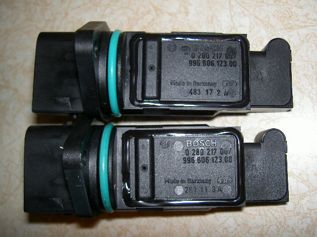

Ok, new MAF arrived this afternoon and it is now installed. It is exactly the same as the stock one I pulled out :thumbup: The car sems to be running fine. The picture of both sensors is attached; new one on top...

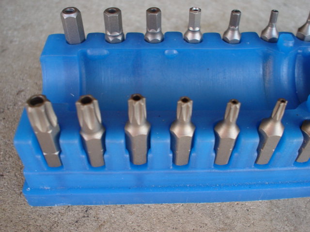

To remove the 2 anti-tamper Torx screws you need a T20 anti-tamper bit. This bit has a hole on the end. This is my set of bits.
