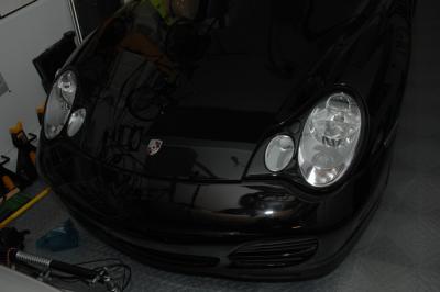

Installed the headlight covers and painted washer covers. The thickness of the headlight cover makes it difficult to insert the washer head units. The trick is to have one person hold the washer cover and the second person turns on the headlight washer.

Had them painted at a local body shop, installed them by taking the headlight assembly out to cement the cover on, used card board and wire ties to hold them on while the cement dried over night. I got the complete washer inserts (Porsche dealer) which the body shop painted. The cement comes with the covers.

Just curious, since you cemented the covers on...why didn't you just paint the headlights? I thought the Techart covers could be removed?

Haven't seen the headlights painted, would like to see an example. Don't know if you could remove the cemented covers, not sure why I would remove them. If I wanted to do that I would just buy new head lights.
