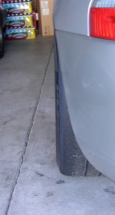

The "ideal" offset for a 10" wheel is about 40 i.e. such that the wheel/tire is flush with the outer edge of the wheel well. Attached is a pic of an 18x10 et40 wheel with a 265 tire.
Up to 285s can fit but you may have to play with different sized spacers. (I have had 285s on my 18x10 et40 wheels ) Also the sides of the car are not necessarily exactly the same. What works on one side may not work on the other. Up to 275 is usually not as critical. 265s are easiest and there is more tire choice.

Hmmm, ar38070, you seem to have some sticky tires there :)
265s with ET40 will have no brake cable rubbing issues. You do not need ET40 to fit 285s, though. ET40 with 285s starts getting close to the fender (again depending on various manuf tolerances and if your car is lowered). I also disagree with Wheel Enhancement after studying this for years.
