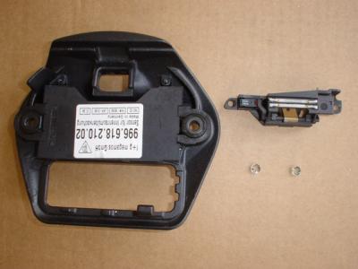

The switch for a 1999 is 986 613 795 02. The retaining clip is 999 507 534 02 and you need two of them.
In the pic the switch is on the right and the clips below.
