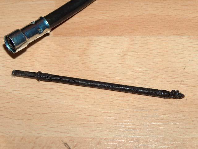

There is no fix for a broken drive cable. It needs to be replaced.
This is not my picture but I saw a car (it was a 2002) just like this 2 weeks ago being worked on by Van. The twisting of the cable as the top goes up and down causes it to fail.
Never seen this happen on a 1997-2000 with the original style cables that were sided. On 1997-2000 there was a left and a right cable. On the newer cars there are still 2 cables, but they are identical as there is no left and right .
The old style sided cables had all the little wires running in one direction for the left side and in the other direction for the right side. I will have to look at the one cable fits both sides and see if this feature was eliminated and that is why they fail.
