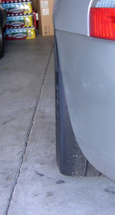

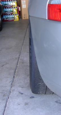

You need to run about 40mm in the rear. Here is a pic of a 265 on a 10" wheel et 40.
Also there are a lot of threads on this topic.
