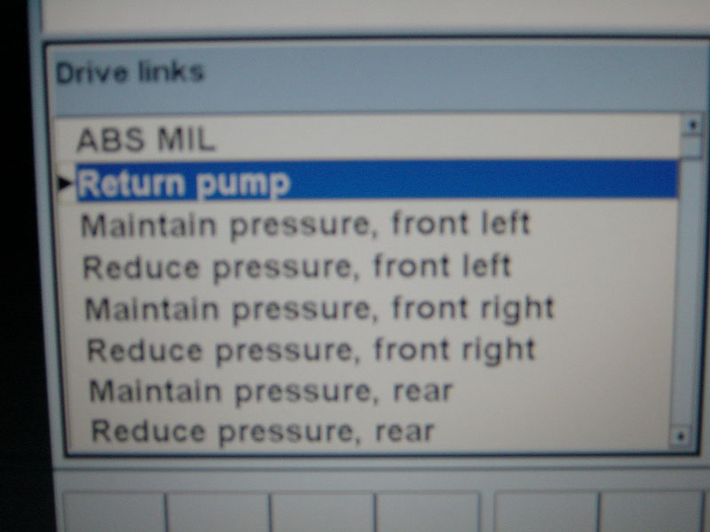

The only way I know to do it is with a PST2 or PIWIS tester. It is one of the items in the ABS control section.
Sorry the pic is a little fuzzy - but you get the idea.
I know you can do it with the PST2 or PIWIS tester, but I have heard numerous times that there is another very easy way to do it without any special testers or Porsche equipment. I cannot believe I forgot the specifics of the rumor.
