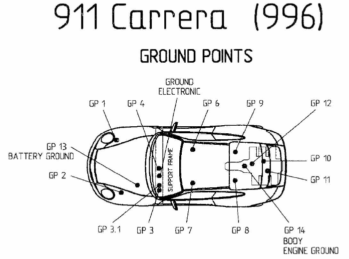

Nope - Did not check those, do you have any information on the ground straps?
Joe
Joe
