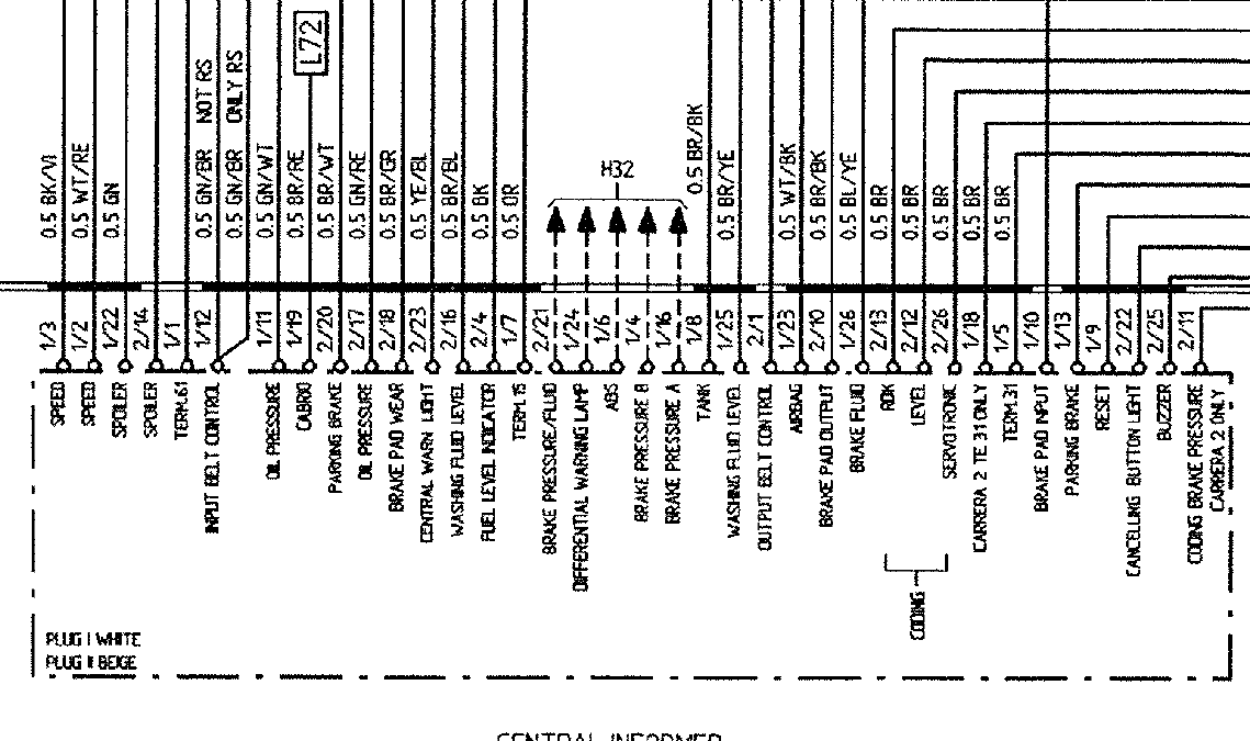

I can't think of the control unit you are talking about. does it have any numbers on it?
It does ... but unfortunately the Porsche is parked at the otherside of the channel :( .... I'm currently in the UK <_<
For a lefthand drive you can find it, sitting in the drivers-seat and dropping your left-hand from the steering-wheel. Now move your hand under the dashboard and move up ... there you'll find an aluminium box - a bit bigger than a packet of cigarettes :lightbulb:
Its mounted on a small frame - which is mounted with two 10mm plastic nuts :wrench: to the body of the car - there are two connectors on the box.
According to my (very old 964 manual) that should be the DME.
I thought the DME was located under the drivers-seat (lefthanddrive) :lightbulb: although the Central Control Box seems to be part of the DME system ;)
My mistake I thought you said under the driver seat.
I believe that is the central informer (part of the instruments and senders circuit). See below:
Indeed :)
Probably I came up with another name because I translated the German word to Dutch and then to English :cursing:
