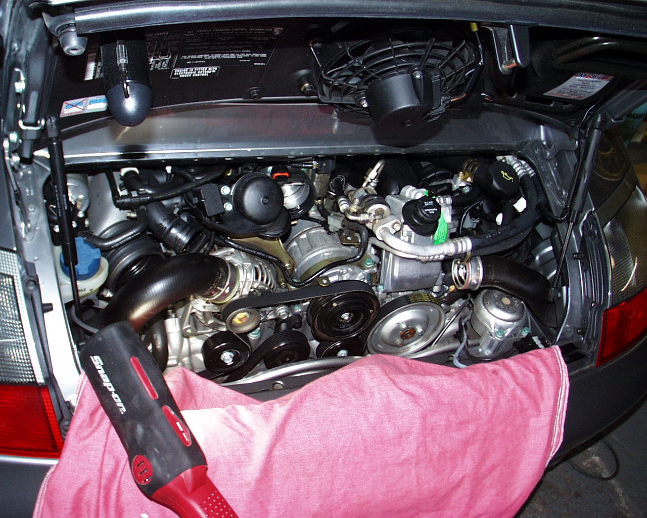

These 3 pictures show the Purge Valve located on the engine of a 2002 996 tt.
The purge valve is part of the fuel vapor system, that is why it is not in your vacuum hose diagram. Why do you want to know about the Purge Valve?
