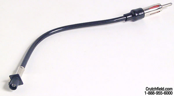

... ok, I bought the Drive&Play and I wanted to install it today, but.... the antenna does not fit.
The CDR24 uses a small, clickable antenna connector whereas the Drive&Play has an old fashioned antenna connector.
Does anybody know the 'name' of the new CDR24 antenna connector so that I can order an adaptor? Fakra? FME?....
Wolfgang
When the CDR23 needed an adapter it was a EU-30, or and EU-10 and EC-20. If the CDR24 is the same then it should be the same adapter(s).
Hi Jeff, in between I also found the answer in the link you sent in another thread (CDR24 Radio Removal) :thumbup: .
The adapters are available at:
www.crutchfield.com
#12040EU20 and #12040EU10
Now I just need to find out where I can get them in Europe :clapping:
