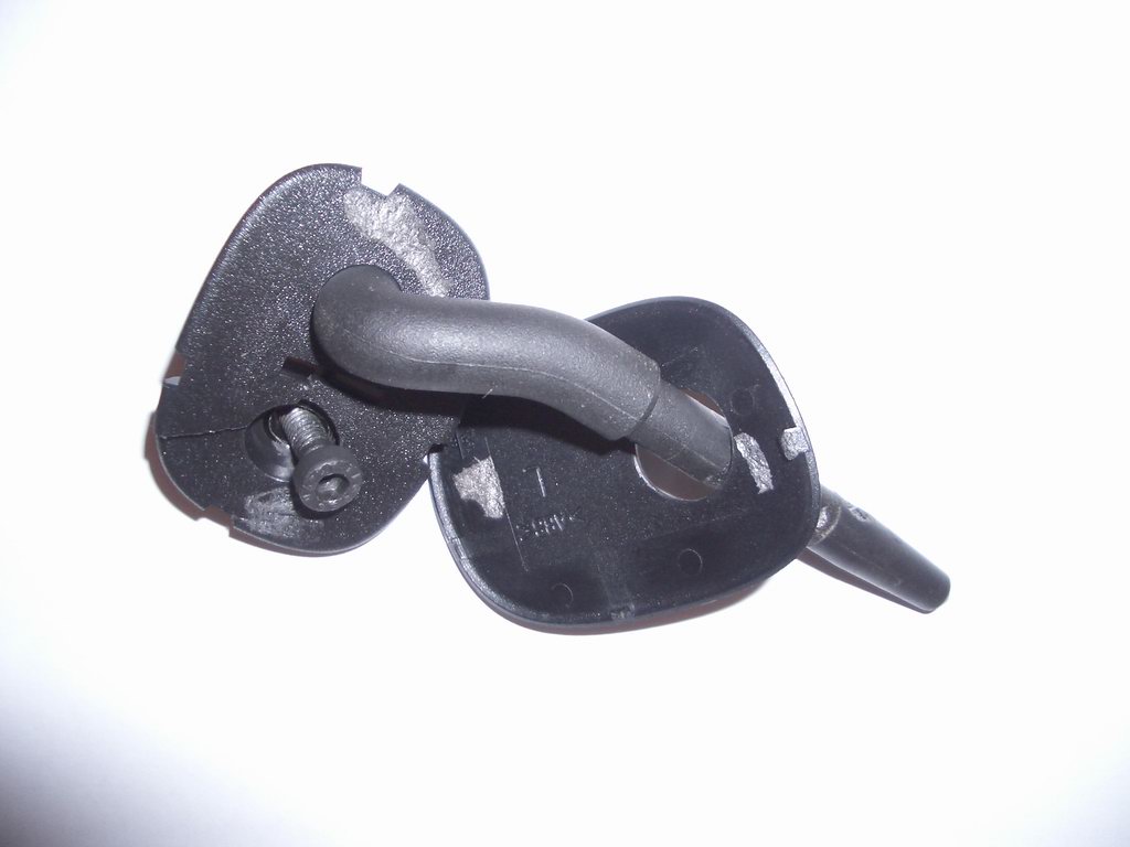

Today I finally got off my fat backside and did some jobs on the car. Put the two twist-off-back tax-disc holders in the 996 and Boxster, and finally sorted the sunvisors on the 996. I removed the LH hinge from the 996 as the hinge cover was stuck on by velcro to the rest of the hinge, leaving it proud of the roof lining and generally unsightly.

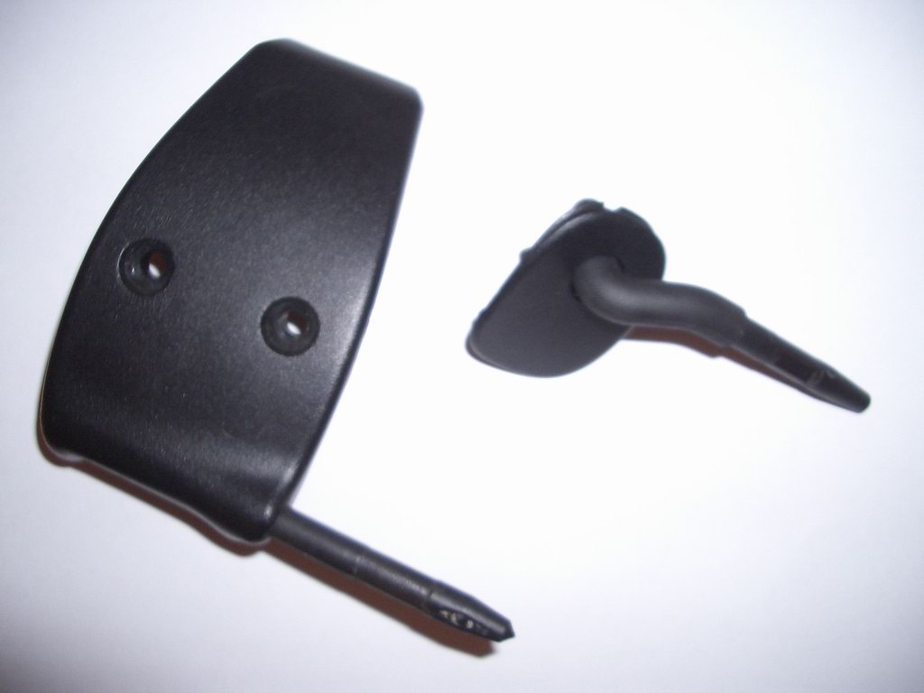

It is on the right of the photo below beside a Boxster (and 996 Cab I suspect) hinge.

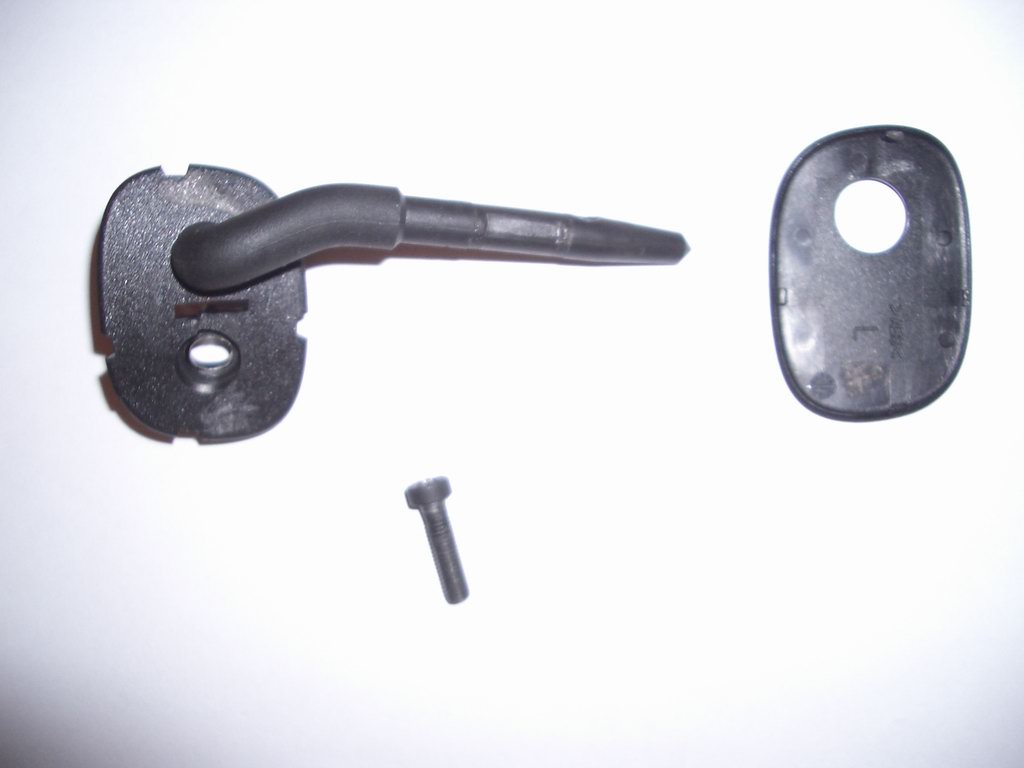

Here are the three parts of the 996 hinge: the hinge, the mounting screw and the cover.
My hinge was broken and I glued it together before reinstalling it.
I would have preferred to replace it but I could not obtain the hinge as a separate part from either the PET or my OPC. I wasn't going to buy a whole new sunvisor for this little part.
