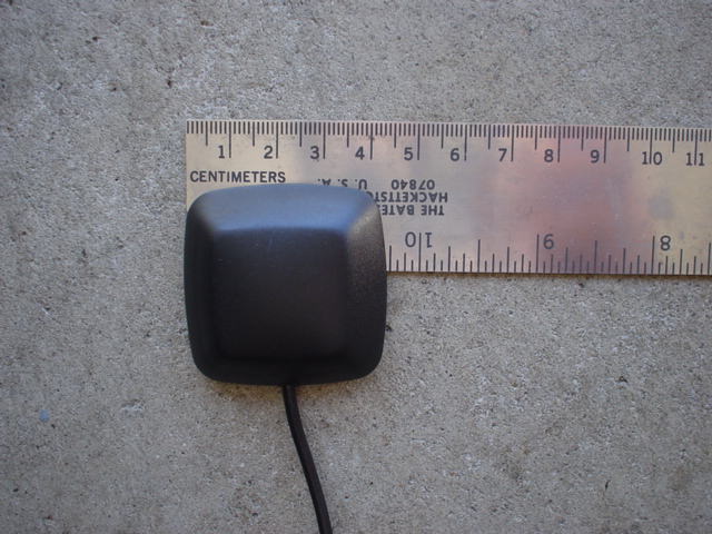

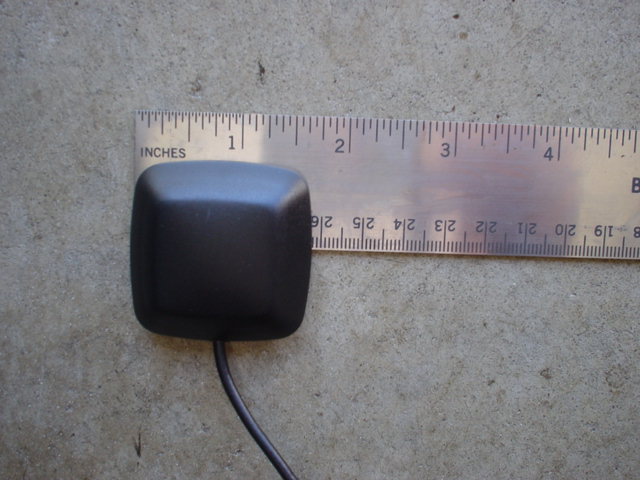

Here is the Traffic Pro gps antenna. I think it is identical in size to what is used for PCM.
Someone said it is also the same size used by Garmin.

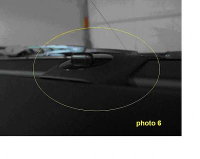

When I put my GPS sensor in, I was able to loosen the bracket that the IR sensor in place and drop the wire in that way instead of going through the defroster vents. This drops the wire directly behind the radio.

I am trying to do this now also. So the IR Sensor in the middle of the dash will POP out if I squeeze from both sides to compress the attaching tabs a little bit. Once I do this I can snake the wire down behind the radio to attach it to the back of the radio? My GPS antennae has a magnetic base.
finally got the gps antennae in. I thought replacing the coolant fans was difficult! I loosened the infrared sensor but did not remove the screws completely and removed the horseshoe on the dash.
