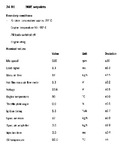

Anyone that have data for the DME (7.8) set points, such as the attachment (valid for C2-99).
I got problem with the codes P0172 and P0175 (O2 sensing below linit) and like to check with the obd reader what all values should be.
The problem have comes up 2 times (after reset) and the car ( 996 TT-03) have been driven for about 60 km every time.
I have checked the system for leakage and (I hope the problem was ) the air inlet tube was a little bit out of position and also 1 screw was loose for the MAF sensor.
I also like to know where the canister vacum hoses/pipe is possible to find (picture)
