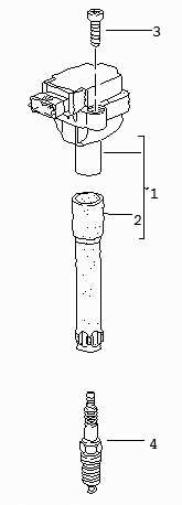

The part number for the coils is: 996 602 104 00

You will get two parts when buy the coils (group item 1). Usually just the top plastic/ceramic part breaks but you should still inspect the wires/connector for damage.
