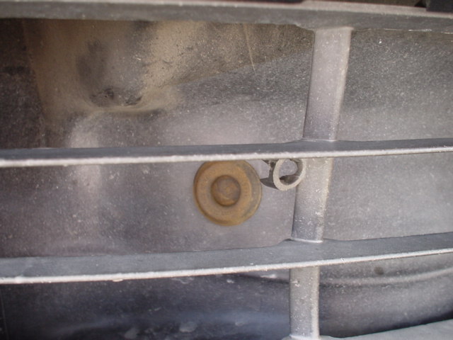

Here is the plug where the sensor would be, on Fong's car.

Loren got his message in before me, and he raises a point since the car may have been repaired.

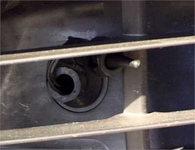

Do you have a picture with the sensor installed to show how it is secured.
I had my bumper replaced and following this there is a loud whistling noise coming from the front end when going other 70 mph.
I think this is because the sensor was badly fitted and is now dangling by its wires in the air intake
Chances are your noise is a bad bumper alignment.
They should loosen the bumper mounting and then retighten it while someone holds it is position. The front bumper should be even with the front hood or you will get noise.
