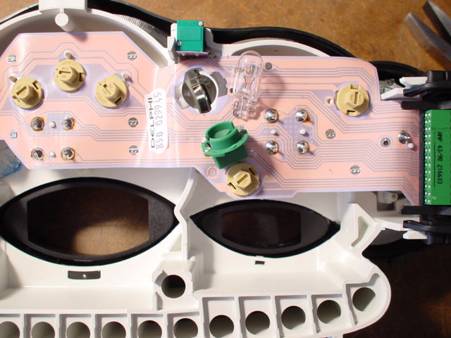

Have the display areas gone completely blank? It may just be that the illumination lamp or LED has failed. You'll need to remove the instument cluster to check this. I can't remember the year that Porsche went to all LED for the illumination.
I did read about bulbs going , but you cant see any numbers at all in that section unfortunately. I assume that if its just the bulb that you could still see the numbers? or is that not true?
Your year has bulbs. Each LCD display has an illumination bulb. When that bulb goes out you cannot see the display. All I can think of is that the bulb just happened to go out when you were working on the radio. You might give the cluster a wack before you pull it to see if it is really the bulb.

Well I removed the cluster from the car and checked the bulb, all seemed fine? So to double check if the bulb was ok I swapped it over with the bulb behind the digital speedo screen, and voila! alls well on all three screens now.
must have been a loose bulb/connection, so now I have TV/CD/Tuner/DVD and sat nav up and running without the hassle of a faulty odometer.

Depending on what bulbs you replaced, you might be replacing the wrong ones. There are also bulbs inside the cluster. There are 2 with green bulb holders that are used to illuminate the analog dials.
