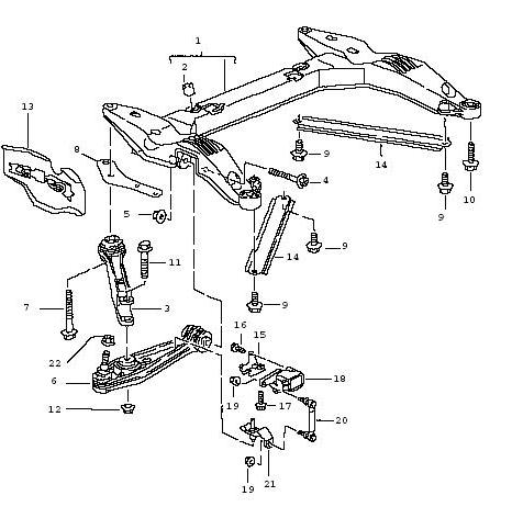

The front suspension:
Is there a camber adjustment point somewhere above, i.e. bolt #4 (it is not identified by PET as eccentric, though)?? Or, is camber set by moving the upper strut mount??

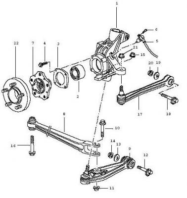

The rear suspension:
The camber adjustment point sure looks like it is bolt #12; or, is it the upper strut mount?? Also, bolt #18 is toe adjustment point, correct?

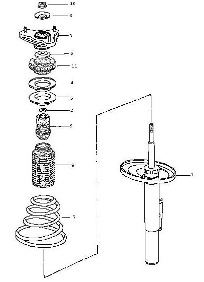

For the front, it's not in the picture. It's the strut top hats. For the rear, it's eccentrics 12 and 18. Toe and camber cannot be adjusted independently in the rear although #18 has a stronger affect on camber while #12 has a stronger affect on toe. The rear is a trial-and-error setup it's so touchy. Also, the top strut hats in the rear have a tiny amount of play (like 0.1 degrees), but it's not designed for adjusting camber.
So, for the front, adjust camber with the upper strut mount #3 (below) by loosening the three nuts, right? Any idea on torque specs? Much abliged. --Brian
