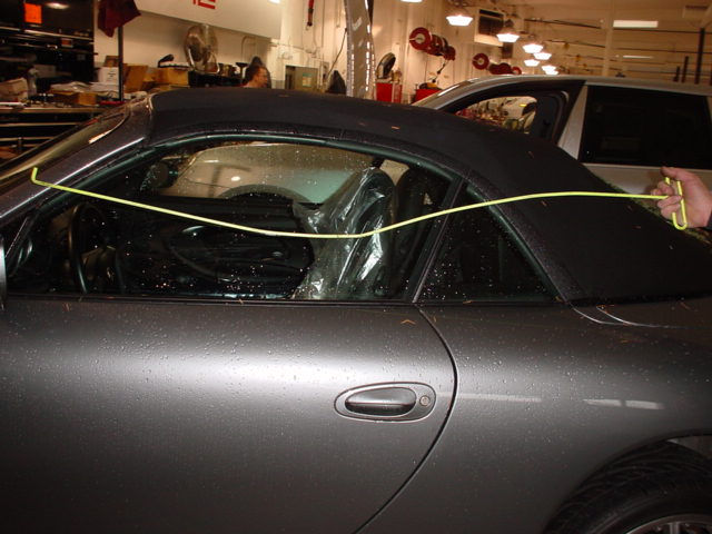

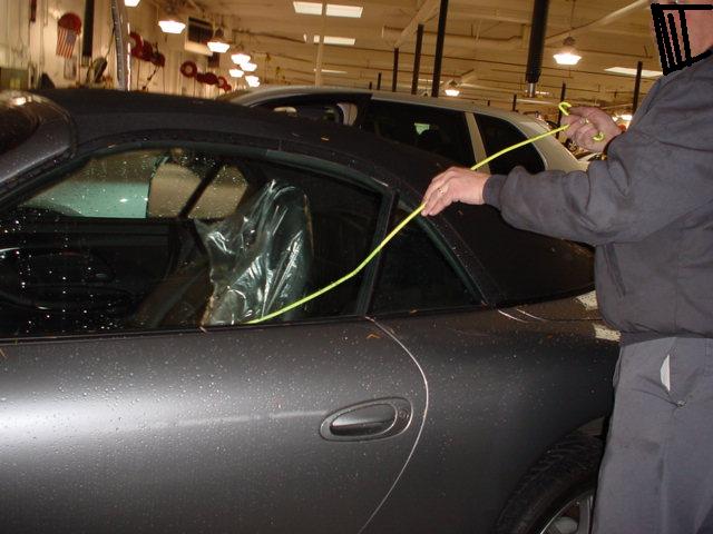

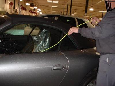

Before you go smashing windows (pricey!!), there is a way to get into the window. Use a wooden wedge to pry the window far enough away from the seal. You take the flat part of the wedge against the seal and slowly (carefully) push it further in to create about 1/4 to 1/2 an inch of clearance to get a tool into the car. The wedges are also available in plastic from slim jim manufacturers. If you can find a dealer or tow service that has the air bag, they work best. It is a small flat bag with an air bulb connected to it. You slide the bag between the glass and the seal then use the bulb to blow it up causing an opening.
Then you use a long sturdy bendable piece of metal rod with tape on the end to protect your interior. You can get a long one to try to tap the lock/unlock button on the dash or just pull back on the interior door handle.
