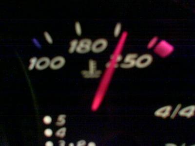

whenever i drive my Boxster for more than an hour the temp goes up to more than the half as you can see in the picture. the coolant level is ok. if i turn off the air conditioner the temp goes back to normal (ie. half). i live in a very hot country and these days the temp is around 120 Fahrenheit (50 celsius).
the specs are as follows:-
boxster (2.7) model 2000
tiptronic
US specs
60k kilometers
so please let me know if this is normal or there is something wrong?
if something is wrong what can be the cause?
thanks.

The air conditioner gas coils are located in front of your engine coolant radiators. As such, the air flowing through the front of your car has to get through the air conditioner gas coils, then to the engine radiators. Any heat picked up through the aircon coils gets passed through the engine radiators. This is partly the reason for hotter engine temperature gauge readings after you switch the air conditioner on.
In addition, there may be (I am not sure if these are fitted to the Boxster) a transmission oil cooling coil within the engine radiators on a separate curcuit - which is contributing as well to your water temperature. Since you live in a very hot environment - you may well be seeing a normal temperature reading.
Do you see this high reading when your weather cools down later in the season? If your high temperature reading follows the hot weather season where you live, all may be completely normal.
You may also want to check to see if there are any dead leaves or other rubbish caught in the entry to your cooling radiators - a build up of dirt, dust & trash can really plug the airflow - resulting in the same types of high heat readings. Start with a good spray of water in through the front of the air entry nostrils and then see if you can remove any plastic grilles - get your hand in there and feel around for any foreign matter.

Something is definitely wrong with your car.
A friend has a 2000 tip and the only time it would over heat was at the track in 95+ degree weather. He solved his problem by adding the third S radiator and an S bumper cover.

I have the standard transmission S (includes the center radiator) and have never seen the temperature creep above normal - including 105F track day and 1 hour average speed over 100mph at around 95 degrees. The comparison isn't that good since these were in the low humidity deserts of Arizona and New Mexico.
I think the problem is with the heat generated by the air conditioner, I drove my car for about three hours and this time I didn’t choose the air conditioner’s temp to be set to 'low' instead I chose 20º C and the A/C air flow I set it just 2 levels up.
This way my cars temp remained in the half.
I know if I had turned the A/C to low temp and increased the air flow of the A/C again my car's temp will increase.
But this is not a solution as in such a hot weather we all need the A/C to be freezing.
Sounds like you need more cooling capacity --> add the third radiator.
Another thought, you might want to be sure that your radiator fans are working properly.
They are quite loud when running. If the car is sitting and running the fans should be cycling on and off.
When the car is cold start the car, the fans wont be running. Note the sound level. Drive the car. When you stop, note the sound level. If it is the same okay. Let the car sit while idling, assuming it is pretty warm, 80+ degrees F, then after a few minutes of idling the fans should turn on.

Unless you've replaced the engine with a bigger one, you should not be having cooling trouble unless something is wrong.
How is your coolant level? Check it one morning, drive it that day then check it the next morning and see if it's going down. You could have the infamous cracked reservoir with a mystery leak you can't see. Lift your trunk carpet and see if there's any coolant under it or any signs of dried coolant. If the tank is cracked, even though it may not leak to below the minimum mark, it messes up the pressure so the flow is not as strong as it should be. Just did that in mine and everything is back to normal, even on the 95F+ days the engine stays at around 195-200F. :clapping:
The A/C compressor does generate a ton of heat and the engine compartment fan is what cools it. Any time your engine temp is above 180F the engine compartment fan should be on when the A/C compressor is on.
Check and make sure none of your vents are clogged with leaves, etc. too.
Also, check the water pump and make sure it's working properly.
Even if you add the third radiator because of the heat in your area, you need to find the problem or it will just get worse.

regarding my boxster overheating, i've just noticed that the left side radiator fan has a higher sound than the right side. and i've tested the air sucking power(by putting a tissue paper infront of the front vents) and noticed that the left side with higher sound is sucking the air very well but the right side radiator has no Noticeable sucking power but yet it has some sound coming out of it but not as loud as the left one.
is that normal?(i mean do both the fans operate together? or its possible one at a time?)
and if something is wrong then what could it be?
do i need to change the fan? or it has to do something with the electrical part?
whats the estimate cost of changing the fan?
please anyone who had the same problem can share their opinion with me.

My overheating problem finally ended,
one of my radiator fan was dead!
I took it to the dealer they changed the fan for usd 400
and now everything is ok :)
