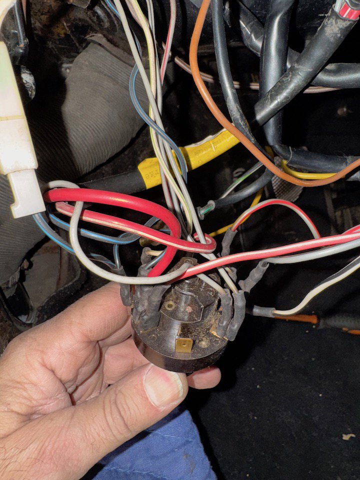

1981 911.  This is what I came up with for the order and wires in their relative order.  Correct?  Another question is the yellow wire off the cable in pic, it is connector to itself or to another wire?..I ask because, when I removed the broken headlight switch from the column the 2 yellow wire were connected to each other, but when replacing it the new switch cable had 1 yellow end for use, and the other yellow end was taped up as if it was not for use.  Can you tell me where those yellow wire connect (pic 1)?  Thanks!
I am not getting headlights but all other lights are on.

What year is your car? I have wiring diagrams for 84-89.
Have you checked your turn signal/headlight dimmer stalk switch-very common for this to cause headlight issues.
