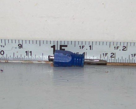

This job requires you to squirm under and work under the dash board. Space is tight and mounting screws difficult to find. Then it takes a perfectly sized small screw driver to undo the old module. The attached picture shows mine.
