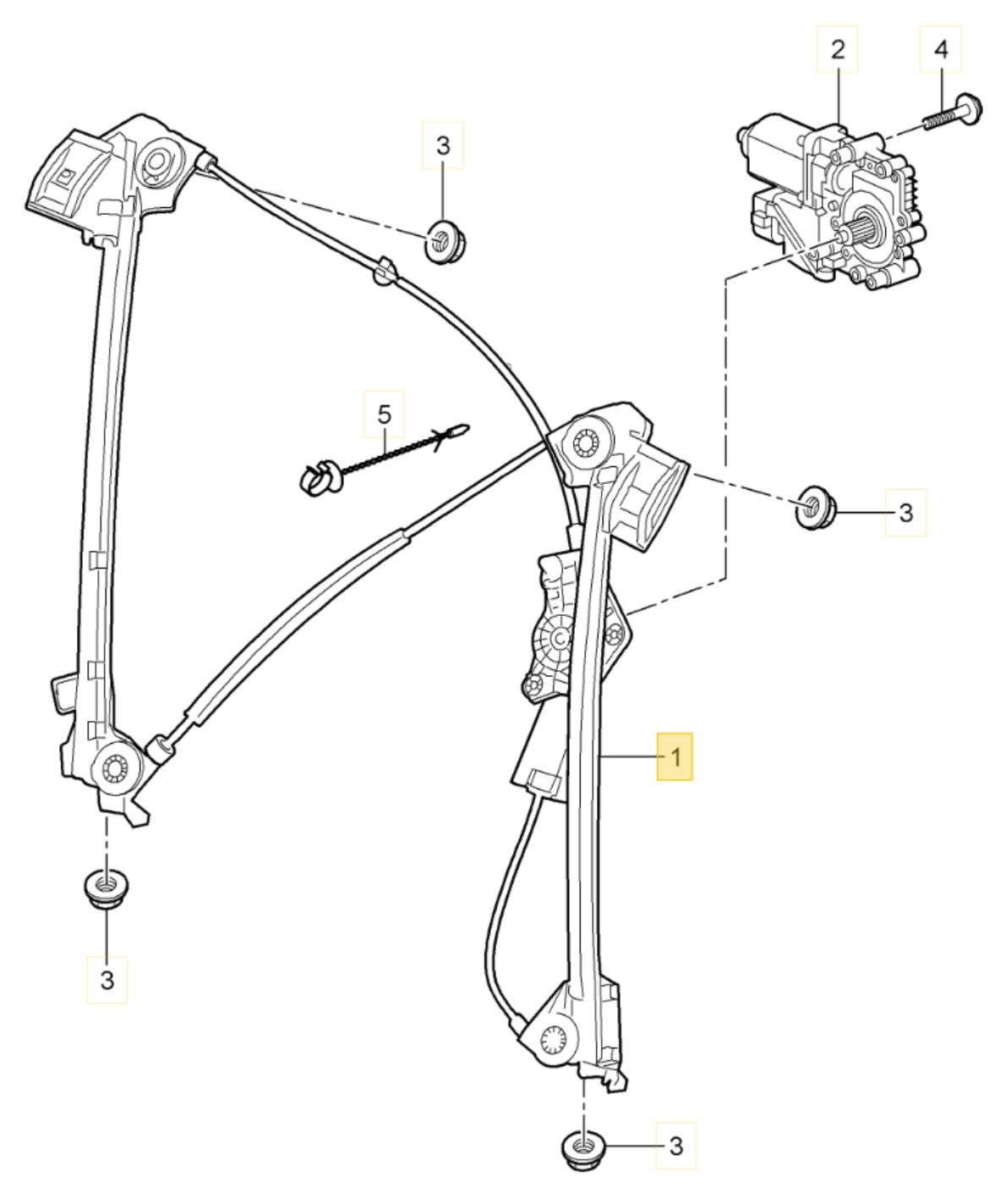

Hello, my passenger side window has stopped working on my 2005 Carrera S. Fuses are good, I pulled the door panel and I can hear a clicking noise when I activate the switch. No movement though. Do I need to replace the entire motor assembly 997-624-104-105 or could it be easier than that?
Any tips or suggestions would be most welcome.
