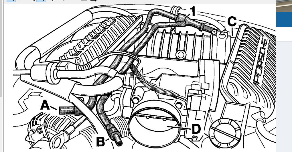

There is a little vacuum valve that alldata calls a sucking jet pump. I can't find the part # anywhere. It is supposed to increase vacuum for brakes. ITs the dark gray line here.
I need the dark grey and the fittings on their ends. I can not find this anywhere. Thanks for the help.

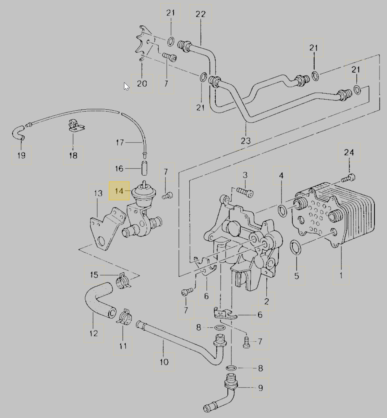

I think you are talking about the Tiptronic Gear oil cooler oil pressure line for gearbox oil cooling.
(always best if you tell us what the problem is or what you are trying to fix)
No, this is a vacuum line that sits over the top of the motor. It looks exactly as pictured. The symptoms were exactly that of a major vacuum leak. The car will no longer start. I have removed this piece already and the end of it broke off at connection c, which bolts into an elbow mounted on the back side of the manifold.

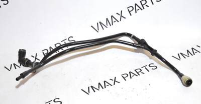

Here it is on eBay. But I don't want to buy used since mine is loaded with stress cracks. It broke at the white air fitting (broke off into hose). So I need to replace. Looks like this eBay listing has a part number so I'll check that.
