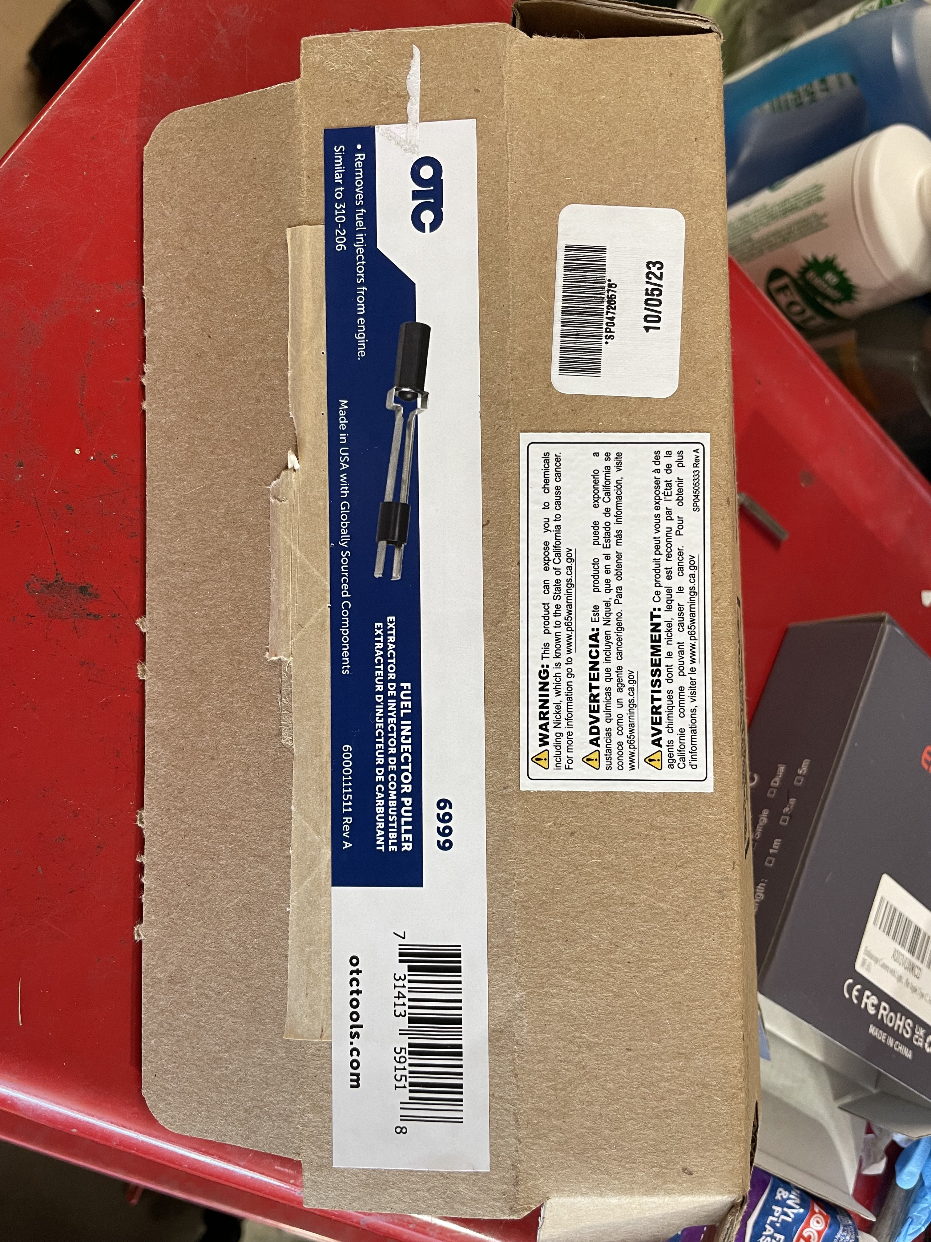

I found a tool that I took a chance on and it worked! It is ‘OTC 6999’.
i have a attached a pic to illustrate.
