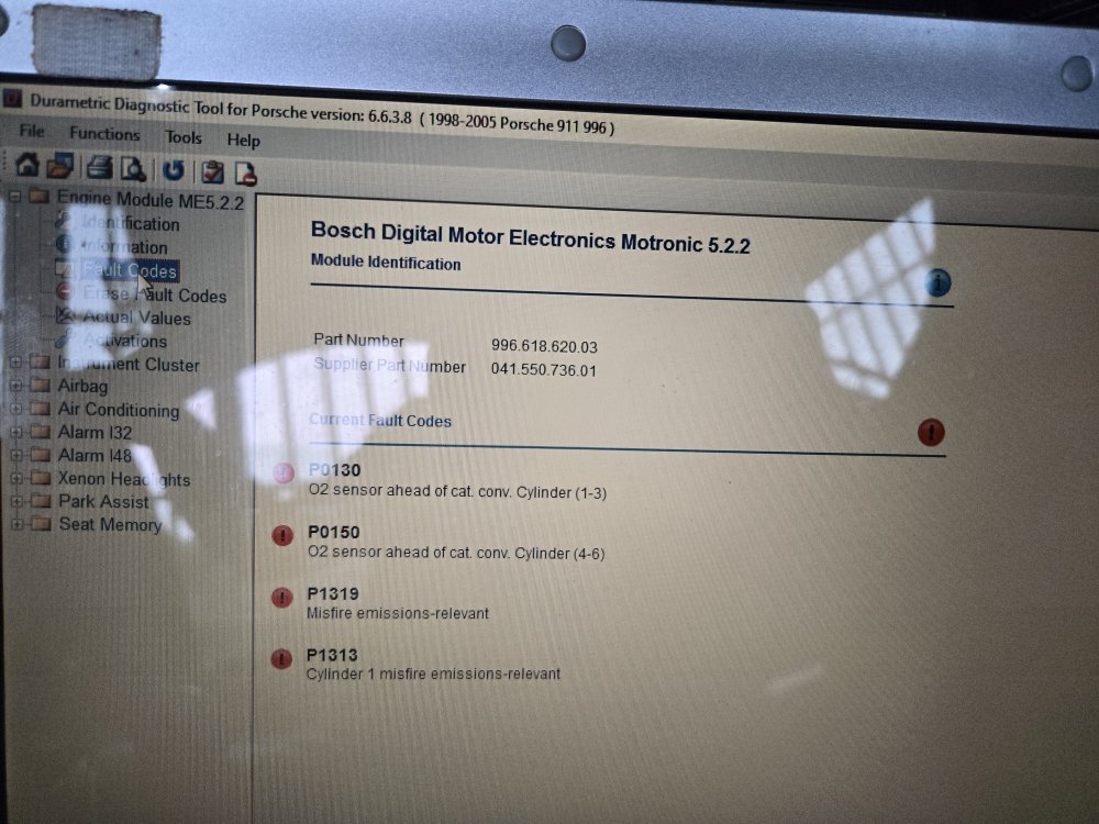

Having rough runing. Durametrics scan this codes. Seems the problem can be cylinder #1 misfire. What can be the possibles issues? Spark plugs? Coil #1? Anything else?
Thanks in advance
The P0130 and 0150 codes are both potential wiring harness issues (shorts or low voltage signals).  If the car was in my shop, I would make note of the codes and then clear them all, and then take the car out for a run to see what comes back.  It is unusual for both O2 sensors ahead of the main cat to develop problems simultaneously, so it could be a harness problem rather than the sensors themselves.  If the 0130 and 0150 codes return, I would check the sensors themselves for the correct voltages; if they check out, I would start looking at the harness for shorts or other issues.  The misfires could be connected to the sensor issues, or a coil or plug problem.
Thanks for reply,
I cleared the codes and reappeared again. What mean the P1313? Can a Single coil problem cause the simultaneous O2 sensor bilateral?

Not really, the misfire may just be a separate issue, but a misfire on one bank cannot cause an O2 issue on the other bank.

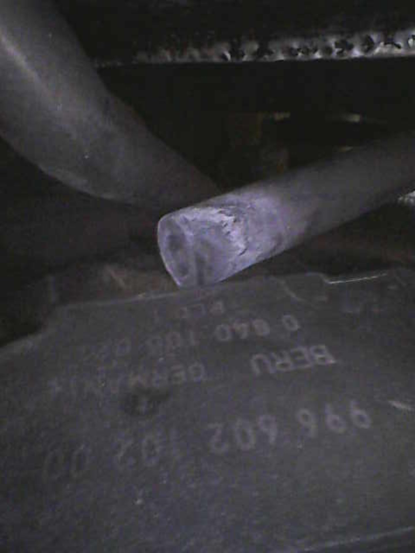

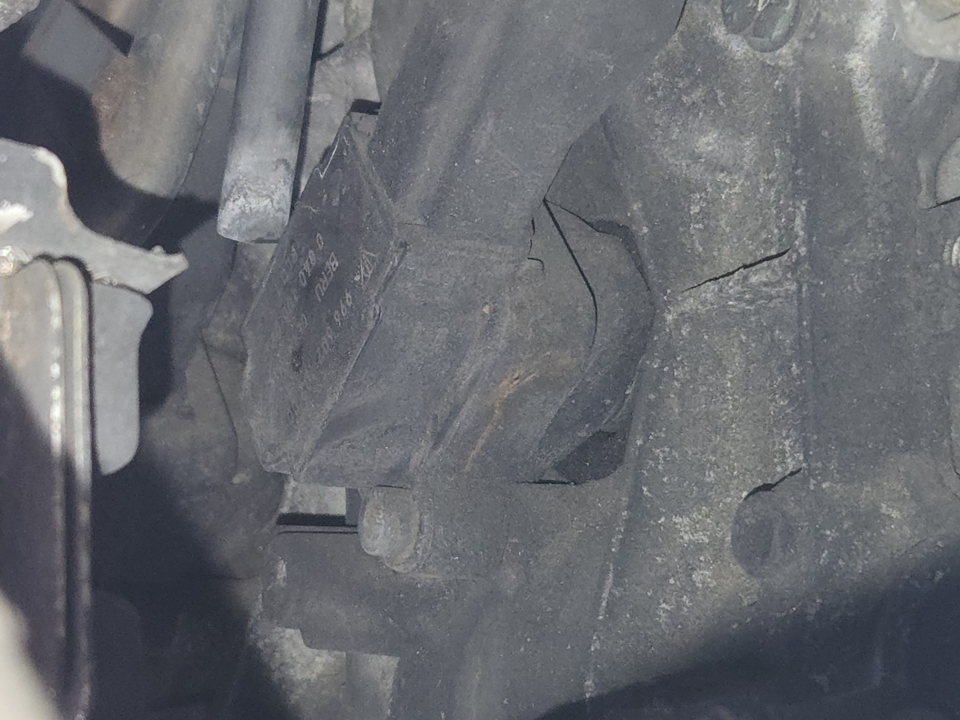

I have an update pictures of cylinder #1 coil. Coolant reservoir hose might be the culprit.
Edited by jose
I cannot understand why this hose was there. My last mechanic replaced the waterpump and coolant cap not too many miles ago.
I made a purchased same brand "beru". I will attempt to do it my self and reroute the hose. I'll rescan and report results.

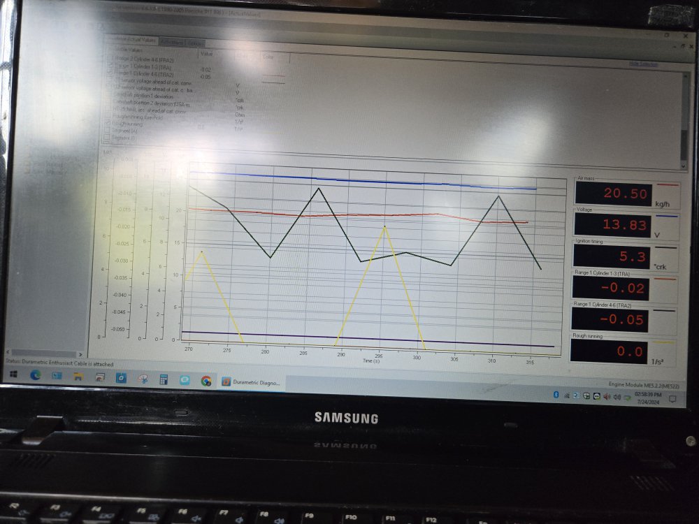

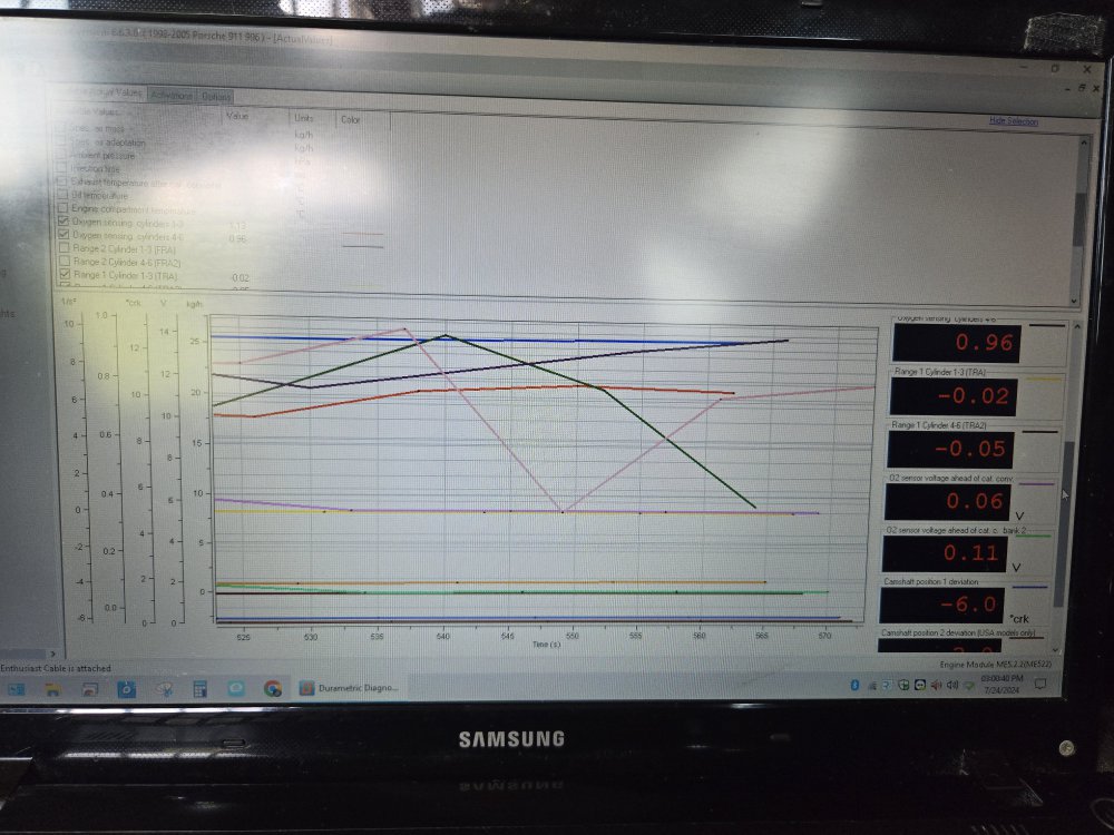

I had this actual values. Anything wrong here?

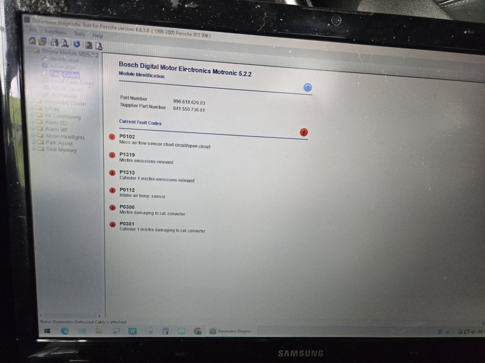

MAF was unplugged. Put it back. CEL came back.

It is extremely hard to read your screen shots due to the reflections, but from what I can see, the O2 sensors look like they are performing correctly.
As for the misfires, you are going to need much more than the diagnostic software to trace it.  The coil packs on these engines have multiple leads running to them, which would require a wiring diagram for you decipher which is which.  One wire carries a 12V signal on it at all times the engine is running, another of the wires runs all the way to the DME where the DME creates a momentary ground at the moment the coil should fire; you would need a digital multimeter to check these harness wires for the correct voltage on the power lead, and a ground signal on the wiring going to the DME only when the DME creates it; if shows a ground at any other time, there is a short to ground between the coil and the DME causing it to constantly fire; if there is no short to ground, the DME MUST create a momentary ground at the correct crank rotation point for the coil to fire the plug. If that is not happening, either the wire is cut before it reaches the DME, or the DME is acting up.

Must add an important point. I Replaced the coil and erased code retest it but in the process I cleaned the MAF sensor and forgot connect it back. Again, erase it took those screenshot. No check engine light yet. But engine feels rough "idle".
If you ran it without the MAF connected, the engine should idle fine.
An update. Summary insert MAF, cleared CEL, started vehicle idle. Codes are reduced to three codes.
