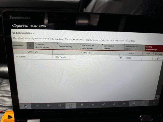

However, my factory backup camera isn’t activating. I’ve manually actuated the motor, it works, and the control signal and camera inputs are correctly wired into the PCM 3.0 head unit. So the issue lies in the coding.
I have a cloned PIWIS 3 tool, which has been great already. I went to check the setting, and sure enough, in the coding options for the PCM I bought, reverse camera wasn’t listed as installed. However even after changing that, still no luck!
Digging around a bit more, it seems the car is looking for a PCM 2?! I guess that’s what must have been installed initially?? Either way, I want to stick with the 3.0 unit. I saw where it appeared I could change this, but it’s asking for a 16 digit code? That’s where I decided I was stuck.
Is this something I’m gonna be forced to go to Porsche for?

Couldn’t find any more helpful info, so I took it to Porsche. They not only gave me a discounted hourly rate because it’s now considered “classic”, but they went thru and re-coded everything the car was supposed to have, tested it all, and performed a recall. I was outta there for under $300 CAD, with everything working. Talk about painless.
