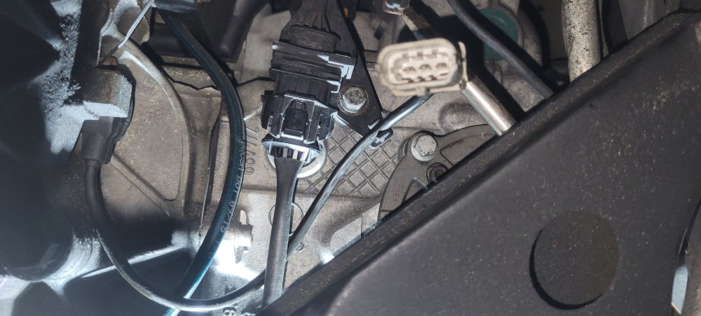

Hello JFP,
I finally got some time to get the car up and get to the connector to test. I attached a picture. I'm assuming pins 1-3 are from left to right based on the picture. Which pins are the ground and the live wire?

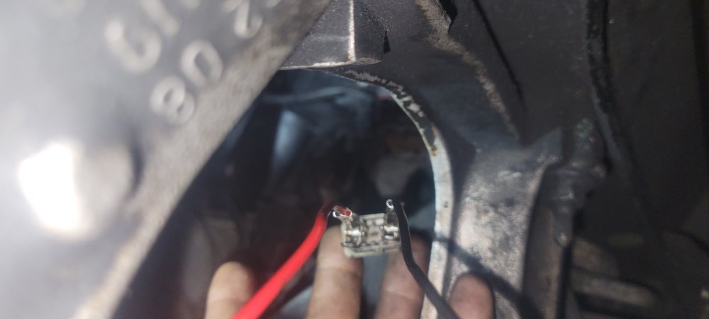

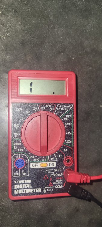

I did a resistance test. Firstly, I tested pins 1 and 2 on the lowest setting. The reading stayed at 1 so I went up to the next highest. I consistently got as high as 911. Next, pins 1 and 3 reading stayed at 1 from the lowest setting up to the highest setting, so really high resistance. Looks like a lot of resistance overall. Do you think the CPS sensor is bad? I attached a few pictures.
