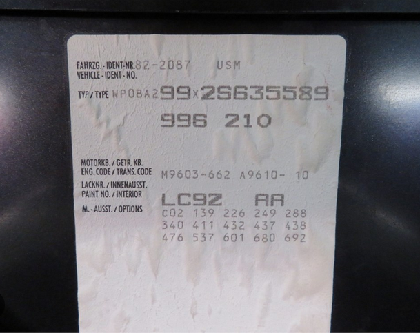

Yes. MB 722. Interesting as you saying they put bigger batteries only to some cars with tiptronic as this someone else's label showing A9610 but no bigger battery.
Q: 82-2087 number on this hood label is it a dealership code or the car's Production Number?
