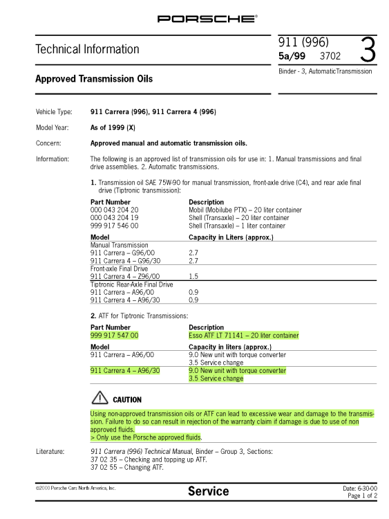

I am having a very hard time finding the Porsche recommended ATF for my 2001 996. Many searches end up talking about a manual transmission or a 996.2 instead of mine. Do you have any recommendations for a reference point or for the fluid? I read that Pelican is suggesting ATF 6. But someone mentioned that is not approved by Porsche and they are recommending due to Pentosin no longer producing ATF 1. I am amazed that it is so difficult to just search and find the proper ATF for a specific model.
Any help or advice as to where I can search would be appreciated.
Todd
I just had the Tiptronic service done at Porsche Fremont April 24 2024 on my 1999 Carrera 4 Cab and the service record indicates part number 00004330527L Transmission Fluid Automatic. Did Porsche Fremont use the correct fluid?
