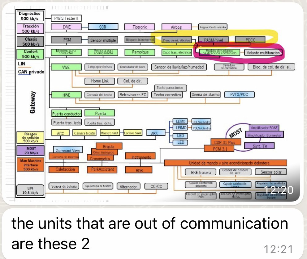

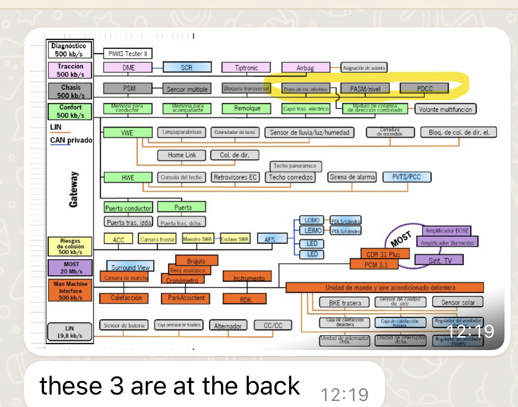

hello, thanks for replying. They haven’t told me. I have requested them. Here is what I saw on the dashboard.
m the current mech wants to change out the a steering mech.
here are his last words.
good morning
Following the digital information wiring harness of the CAN-comfort and CAN-chassis system, the only thing we can see is that there is no continuity between the input and output connection pins of the unit where the steering angle sensor is.
This unit is also the connection between the steering column and the steering wheel control unit.
Fault steering lock
all wheel drive system fault - drive on possible
ABS/PSM failure
Parking brake fault
Chassis system fault
mall wheel drive system overload rear wheels only
