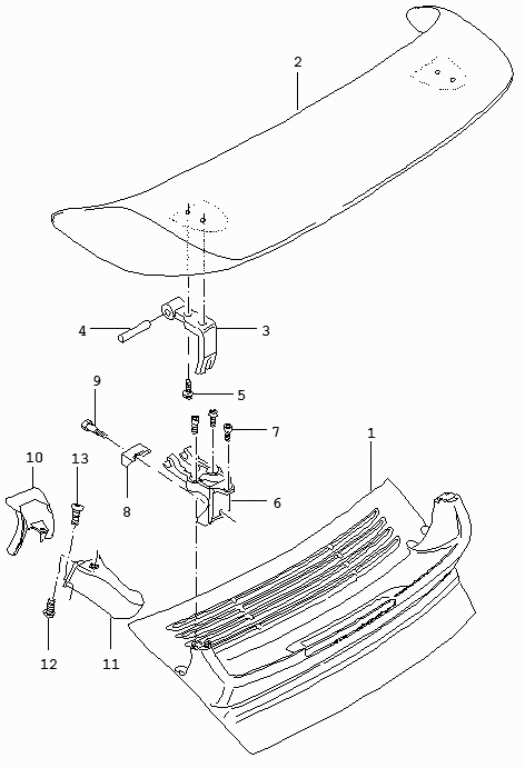

To fit into the new carbon wing from Eric at Bumperplugs, I need to get the old bolts out of the old Turbo rear wing. They are hex (allen) bolts that appear to screw in.
Anyone know the size tool I need to get them out or any other suggestions. It is bigger than a 12mm Allen key

Hi Loren. It is from the stock 996 Turbo rear wing. That diagram looks like the aerokit.

The pieces I apparently need to remove are in the bottom of part 1 and attach to the mounts at the top of pt 2 in the diagram. I have a 14mm allen socket (as required) and am struggling to remove them.
Most spoiler bolts are held in place by Loctite thread locker - so they will snap when they break free. If you are putting the screws back in a new spoiler then be sure and put Loctite on the thread so they don't vibrate loose.
It is done. Loctite and them some. Massive torque needed to shift them!! I have applied plenty of loctite to the new spoiler. Nice big and carbon!! mmm
I think those 'allen' bolts are actually torx head. Porsche usually uses a 20 or 30 tx back there. A allen may strip the head, esp if it's been loctited.
No they are 14mm allen! It just takes some torque to release them (as Lauren said). Use the blue loctite in case you need to switch again.
