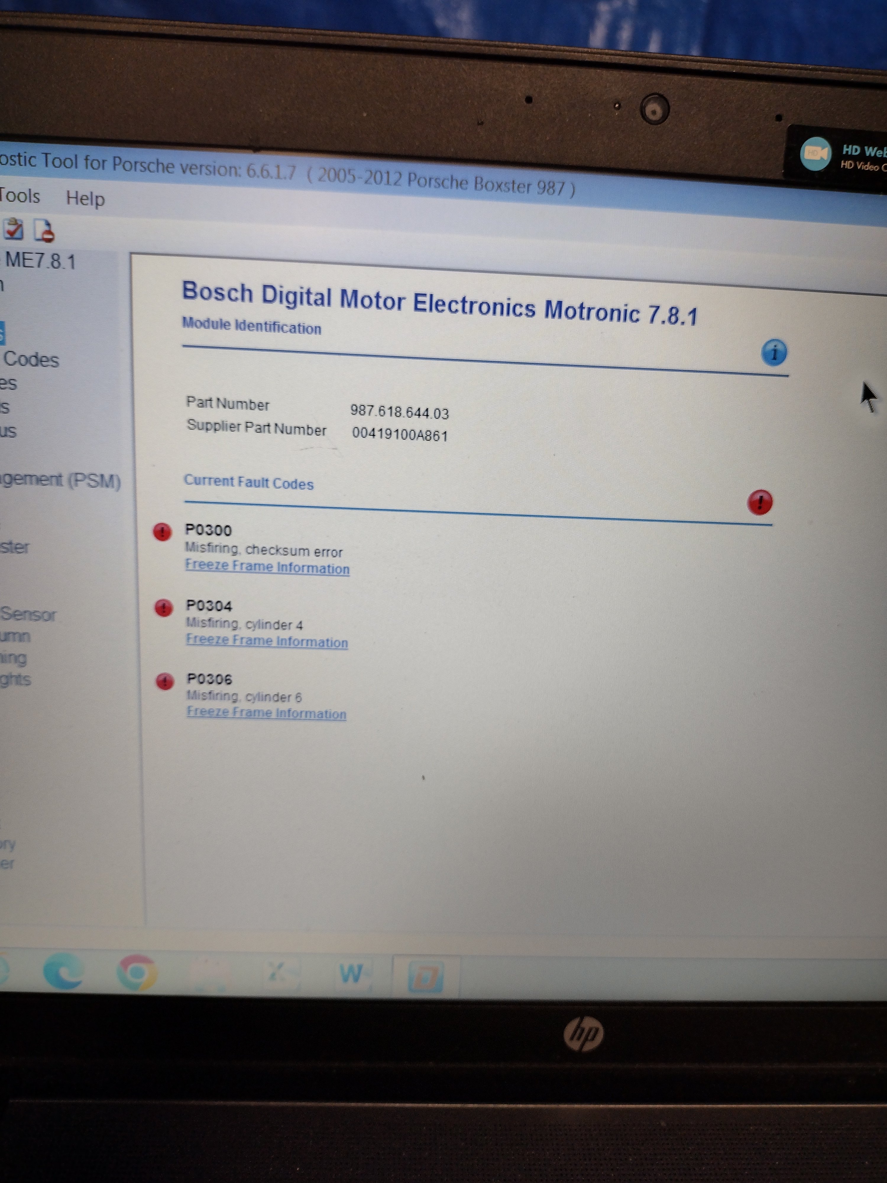

Hi All, Have some misfire CELs  show up. CEL blinks then stops blinking and on some occasions it disappears. Changed plugs and coil packs a year or so ago, not much driving mostly being restored. Was fine and this came up after painting. With using my Durametric I  assume camshaft adj. would  mean activating the variocam solenoids. There was no change in engine note when activated on either bank. There is a change in engine note when valve lift is activated. Cam deviation is nearly 0 both banks. I know with a 99 box I was able to attach a light bulb to the solenoid connecter  to insure voltage was getting through from the DME. Can I do the same w the 08 and I believe it kicks in around 4000 rpms. Thanks VIMG_20231228_165202960_HDR.thumb.jpg.a95acfcef9919a8cb82d58922da52fc2.jpg

Did the light test. Very dim light at idle. Not sure if there's supposed to be current at idle, when rpms were increased the bulb grew brighter I guess voltage was increased along w RPM's.  I removed the solenoid and cleaned and tested it w 9v battery. Seemed to move freely and clicked. Not sure how much the plunger supposed to move. It didn't protrude from the end of the solenoid. Reinstalled with same misfire on 4 and 6. Going to reseat 4 and 6 wires to coil pack see if that does anything. Any ideas? V

Ok, activated bank 2 solenoid with 9v battery and there definitely was change in the engine note(almost stalling). Opened my DME and no evidence of burnt components.Any thoughts to do next. Voltages at the connector? V
