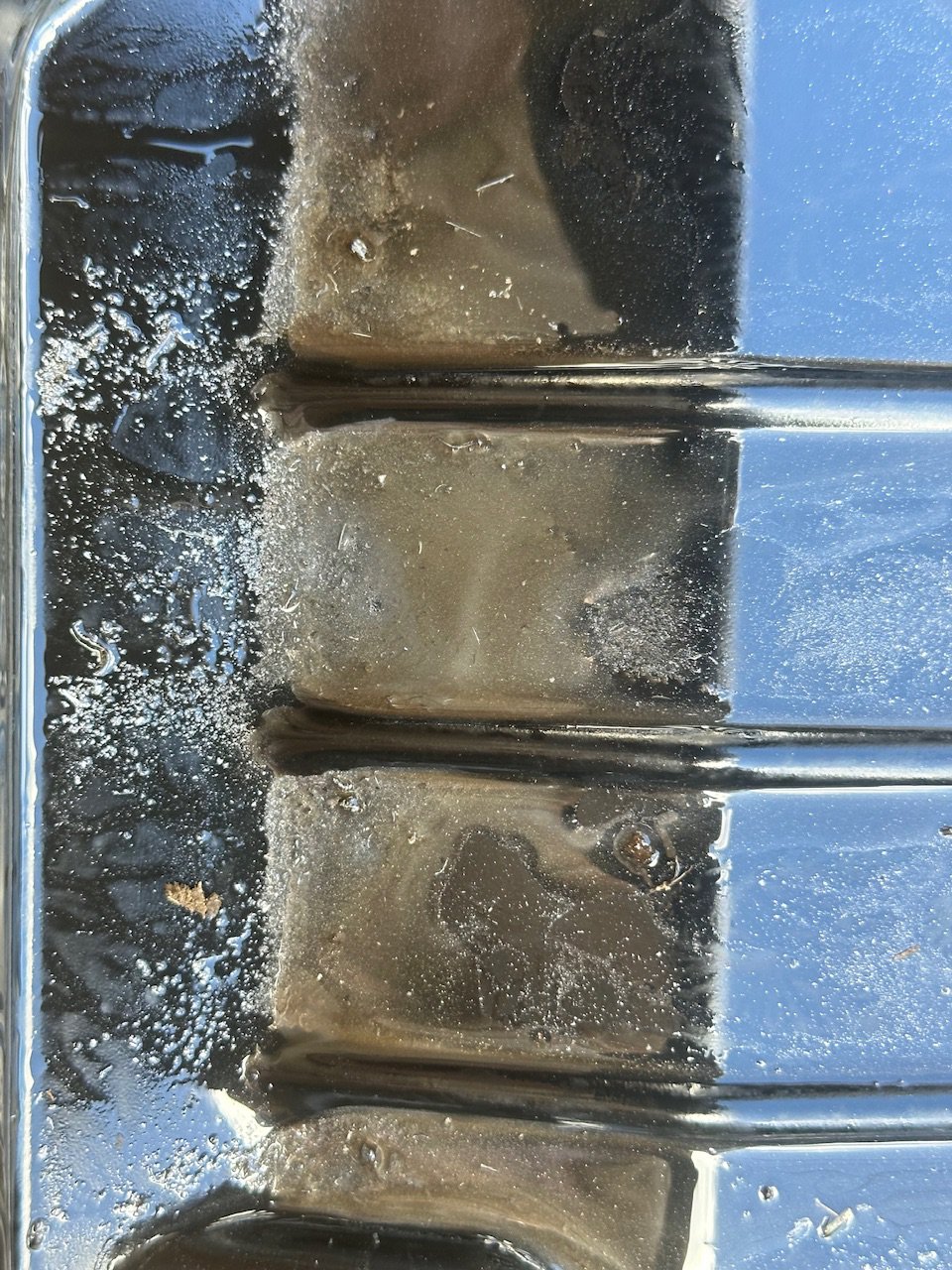

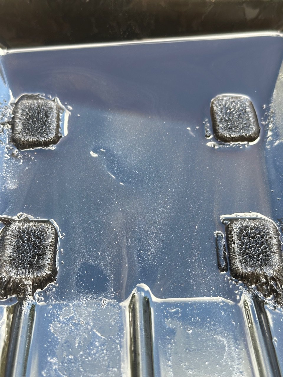

However, a more concerning problem has emerged. Just today, when reversing uphill, I experienced a significant slip in the reverse gear, accompanied by a clunk from the transmission. Following this, the car now slips and fails to engage in reverse, and there's a pronounced whining noise that seems to be coming from the transmission. I took the transmission pan, filter and valve body out and found lots of metal shaving.
