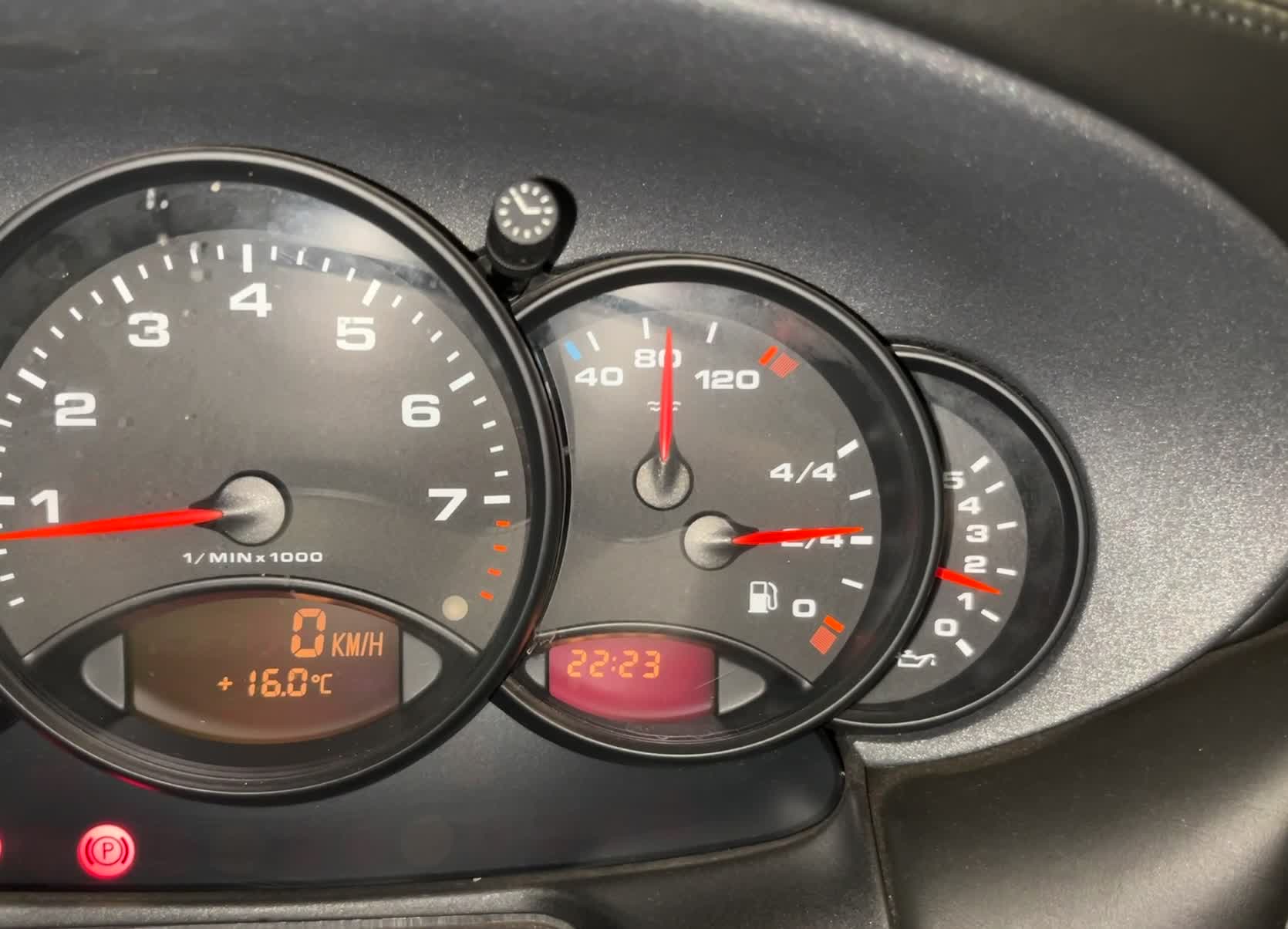

My 996, a late 98 3.4, started to exhibit a strong knocking sound coming from the driver's side of the engine. It's the dreaded "sounds like a lifter" type of knock. Very audible at idle, gets faster & louder as revs increase (haven't revved it past 2.5k):

Also, the car just spent 3 weeks in the shop for a new IMS / clutch, and cylinder #6 was bore checked, with no evidence of scoring found. One of the chain tensioners was also swapped for a good used unit. The oil is brand new (<150 miles), the oil level hasn't changed, and oil pressure is still good (4.5 bar cold). There also isn't a single code on the ECU.

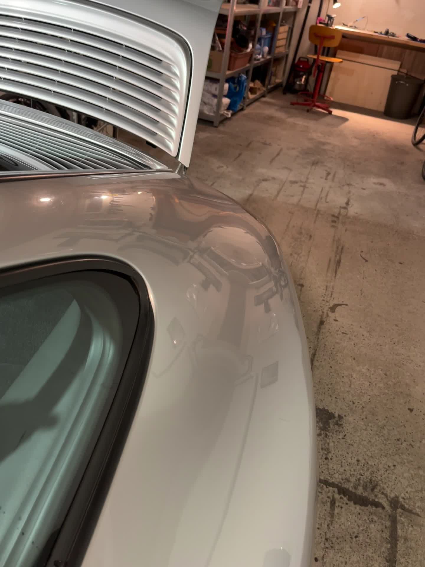

The tailpipes are a bit black on the inside but there's no oily residue in them, nor is there any on the bumper. Overall, this is a very clean car with a full service history, low miles (45k), and "only" four prior owners in 25 years, though it was seldom driven in the past 10 years (6000 miles or so).

Issue turned out to be a collapsted lifter. It went right back up after an oil change. No debris in the filter.
