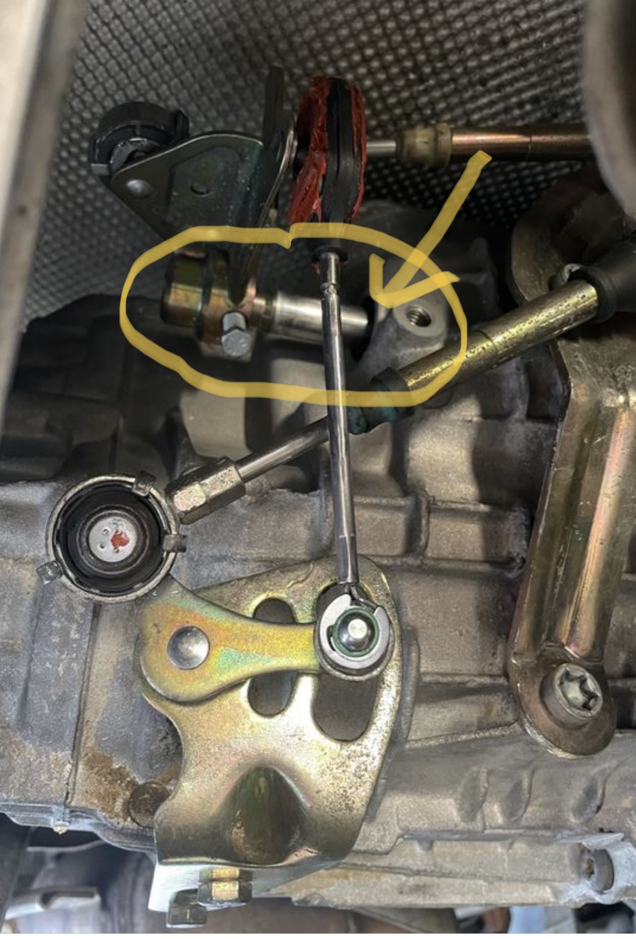

Hello. I have a leak identified in the picture. It is not bad but I can’t seem to find the name of the shaft snd or seal. Also, do I need drop the trans to replace seal.?  Thank you
2000 Porsche 986, manual, 5 speed. 2.7L

Pretty sure that is a pressed in bronze bushing; if it is, the only way to repair it is to pull the gearbox and replace the entire tail housing as the bushing is pressed in from the inside.
Thank you. I pulled the trans couple times two years ago when I did my IMS, clutch and flywheel. At that time there was no leak and it really not much of a leak now but I want things to be right. In this case, I may just leave it. Thanks again!!
