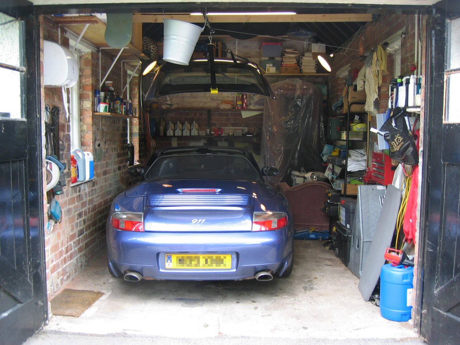

Here's a pic of my setup. Don;t you just love a tidy garage ;)

Scouser... is the bucket part of an elaborate alarm system?  :lol:  :lol:  :lol:
What's scary about it?
And yes, the bucket is the alarm system..........but not so elaborate :clapping:
Seriously though, yeah I know my garage is a bit cluttered (proly an understatement). But it is very functional given that its' the only place in my 18th century home to put my car under cover. My Porker has lived in there for 3 years now and the only problem I have is getting in and out it :roflmao:
Hoist works a treat though.
