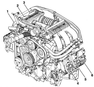

Recently my 97 LHD boxster (48k miles) started misfiring on cylinder 4. I read many of the threads on the issue before but not sure what the solution is.
Car is normal in low revs but as soon as I push it and driving in high revs (6k in 3rd) I get a misfire on cylinder #4.
Is it the O2 sensor (that is what I have been told but not convinced)? If so how do I locate the correct one for cylinder #4?
My understanding based on the reading from other posts is that #4 is the closest to the front on driver side.
If not O2 sensor then what can it be?

How do you know it is on #4. If you are sure I would swap coils and see if the misfire moves to another cylinder. If it does then you have a bad coil.

Swap the spark plug as well just in case you have a bad plug. I suggest you swap with #2 on the other bank because it is easy to get to. Problem is if you still have a misfire then you are going to have to determine if it moved from #4 to #2 which I guess is another trip to the dealer.
Each coil has an electrical connector covered by a rubber boot. Pull that boot back far on the wires so you can disconnect the plastic connector from the coil. When you hook up the connector to the coil make sure the connector is seated or you will have another misfire.
