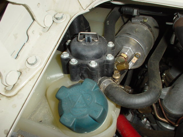

Do any of you have any idea of the reason for the ski sloped part sticking out of the right side of the coolant tank in a 99' C2? :huh: It's on the right side of the tank in the pic posted by Loren above.
For the life of me, I can't see why that piece is there, other than to cause it to be harder to install a new coolant tank. It almost looks as if it is there as some type of support for a pipe of some type. But there is nothing even near it when the tank is installed. I really can't think of why that part of the tank juts out like that.

It is a support for...... something....... Something round with a brass fiting and what looks like a ground wire, and a flow arrow. I would say a fuel filter but that is not where I think it is supposed to be

It did look like a Boxster/996 fuel filter. But what the heck is it doing there, next to a hot motor. At least it does not have plastic lines. Might be time time for pictures of Porsches on fire.

For the life of me, I could not get the new coolant tank back into my 99' C2 with that ski slope on the side. It took me about an hour to pull the old tank, including gathering all the tools, draining the fluid, etc.
Then I sat there for an hour trying to get that *^@$%# new tank in. I just could not find a way, no matter which angle of attack, or which way I twisted it. The ski slope piece seemed to serve no purpose in my car. And every time I tried to put the tank in, the coolant sensor would snag at the bottom, and there was no more clearance up top. I was scared to death I was going to break the sensor off (and on a Sunday).
I followed all of the R&R instructions, and moved or unhooked some other lines as well. I tied things back, and even enlisted the wife. No matter which angle I tried, I could not get it (coolant tank) in. Argh!
So..........., I'm ashamed to say, I chopped that ski slope piece right off the side, and the tank slid right in. But I became overwelmed with fear that I'd done something stupid (again). Thanks for clearing it up for me.
